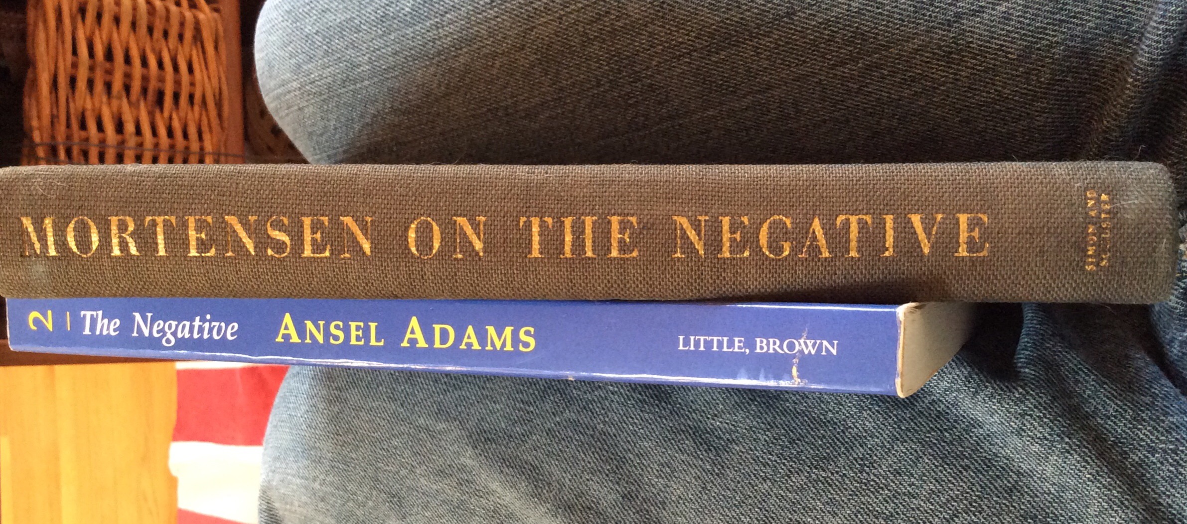

2 books from my photography book collection. Adams book I studied in college. After 30+ years practicing photography using the Zone System, I bought Mortensen’s book. 30 years ago, I was a wide-eyed photography student. Now, I'm just as curious about photography. One book is not better than the other. Just different. Mortensen's book is a lot harder to fine than Ansel Adam's book.
A visual pun! So fitting!
It was actually Mortensen Next to The Negative
2 books from my photography book collection. Adams book I studied in college. After 30+ years practicing photography using the Zone System, I bought Mortensen’s book. 30 years ago, I was a wide-eyed photography student. Now, I'm just as curious about photography. One book is not better than the other. Just different. Mortensen's book is a lot harder to fine than Ansel Adam's book.View attachment 266077
