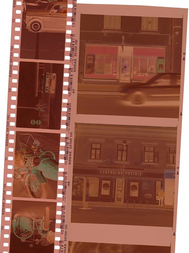

Well one thing stands out to me here: the 120 and 35mm are not being exposed with the same equipment. Using a shutter tester I have found wide variations amongst my various 35mm and 120 cameras- the 120 often with slow leaf shutters in particular which would result in “thick” negatives. Maybe try shooting a gray card with your 35mm and 120 camera then use a transmission densitometer to check the values. If they aren’t close to identical then you likely have an exposure problem. Just food for thought.

brbo
Dec 28, 2011
2,151
EU
Regardless of your metering and cameras you should get very similar min (film border) and max (specular highlights) densities. If not, you should use proper C-41 process (no pre-wash, 3:15 dev (constant agitation), no stop/wash, bleach, wash, fix, stab) with proper chemicals (Kodak, Fuji).

Could you post a picture of some of your negatives, if possible next to a strip of your 35mm negatives (like brbo did)?

I still suspect that the bleach/fixing is insufficient. Even with your method of agitation, there is probably less vigorous movement when agitating the fuller tank with 120 film.
I just read some user reviews of the Yankee Clipper II tank on the B@H site: https://www.bhphotovideo.com/c/product/895914-REG/Yankee_rfc_15t_Clipper_II_Roll_Film.html. On the whole they are not very positive. Perhaps it would be worth trying a different tank?
I don't have any negatives on hand, but I suspect you're right about agitation. Eventually I'll get a new tank. Until then I'm still getting decent prints. It just takes a longer exposure.
