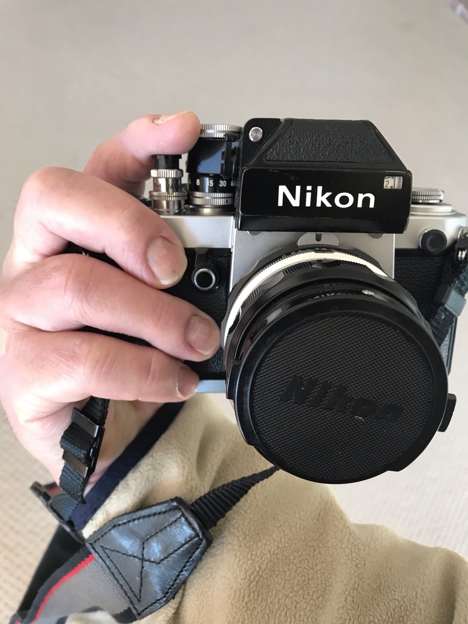

I hate the F2's lockup, I will say. It's not as bad as the Nikkormats' but it is deeply inconvenient to mash down hard on a button and then turn a stiff lever coaxial with the button, especially the way it's mounted on the camera. That would be my main complaint about the F2, actually, besides the way the metered finders put the speed dial up too high off the top deck.
.....complaint about the F2.....the way the metered finders put the speed dial up too high off the top deck.
Get a Nikon AR-1 soft release thingy. It raises the shutter release such that it is just about perfectly situated with respect to the shutter speed dial. It is a huge improvement in the ergonomics.
I might... but it is comfortable to have your middle finger on the DoF preview button and your index on the shutter release, unfortunately.
I'm wondering if they imagined a "shutter-speed priority" style of manual shooting where the shutter speed got changed less than the aperture.
Don't over think it.....
I suppose not. Is that Photomic? I see that it's one of the pre-AI finders.
It is a DP-1 finder. This one was overhauled by Sover Wong and works perfectly but gets relatively little use....and is therefore, the prettiest. I have three Nikon F2 (DP-1, DP-3 and DE-1).
I would love to have both the DE-1 and DP-3. Too bad they sell for such ungodly amounts.
