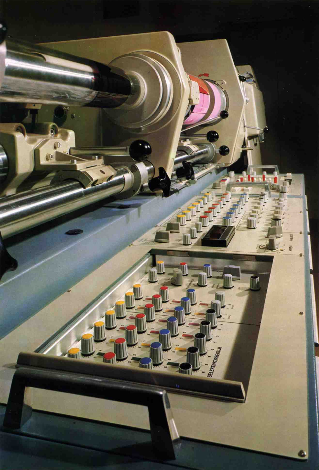

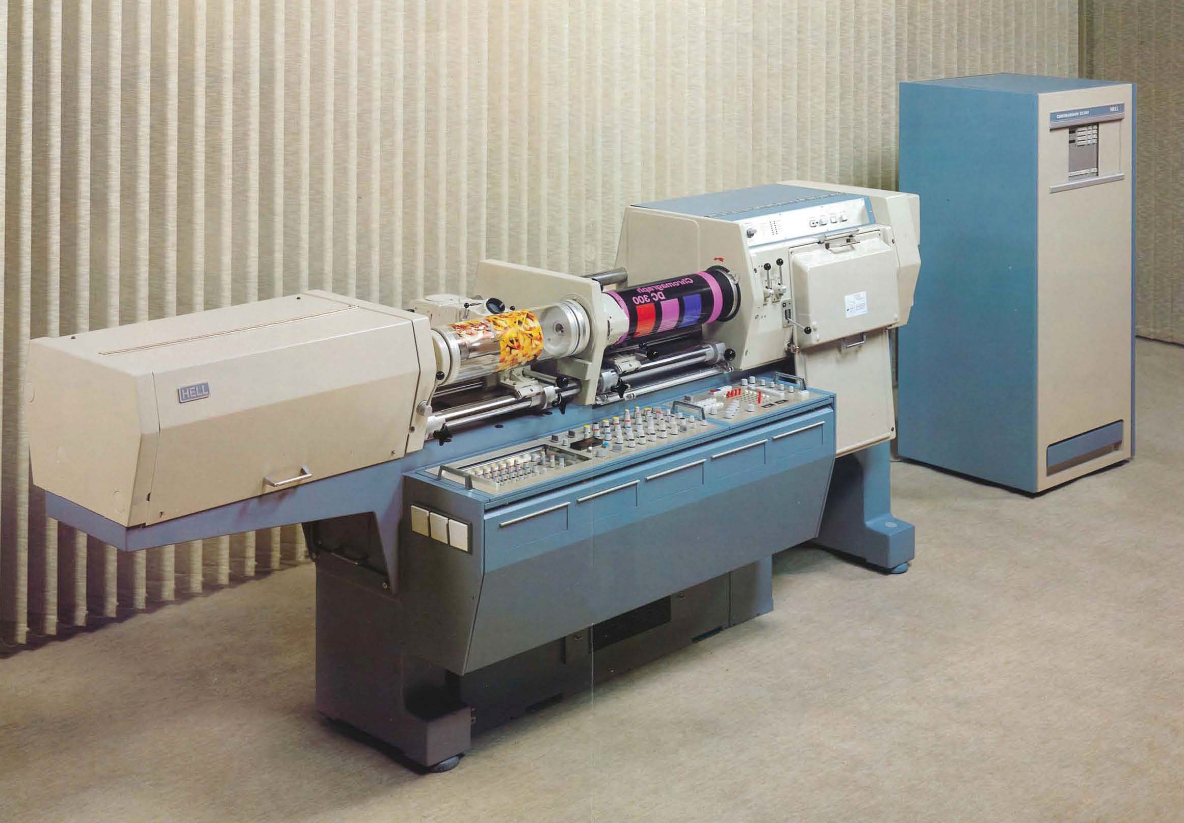

Dr.-Ing. Rudolf Hell made some of the nicest drum scanners from 1963 with the introduction of the Chromagraph scanners.
Here is the DC 300 series, circa 1970s.
