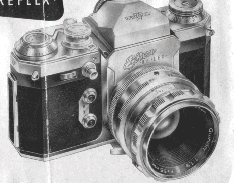

The 50mm lens on my 35mm Edixa reflex (1954-1959) is silver, not black.

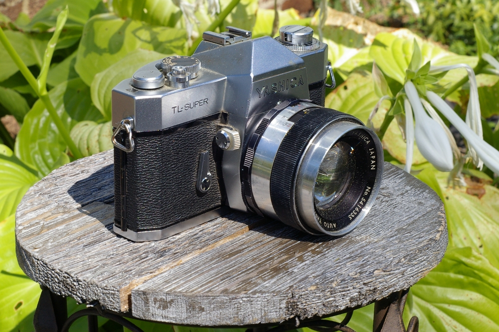

Old Yashica DX 1:1.4 f= 50 mm
Interesting. I have the same camera with a DX 50/2, which has a silver nose and the rear section which on yours is silver (clear anodised aluminium, not chrome) is black on mine. I guess they thought the f;1.4 lens should be shinier!:laugh:
BTW, the same focussing mount was used on both lenses.
