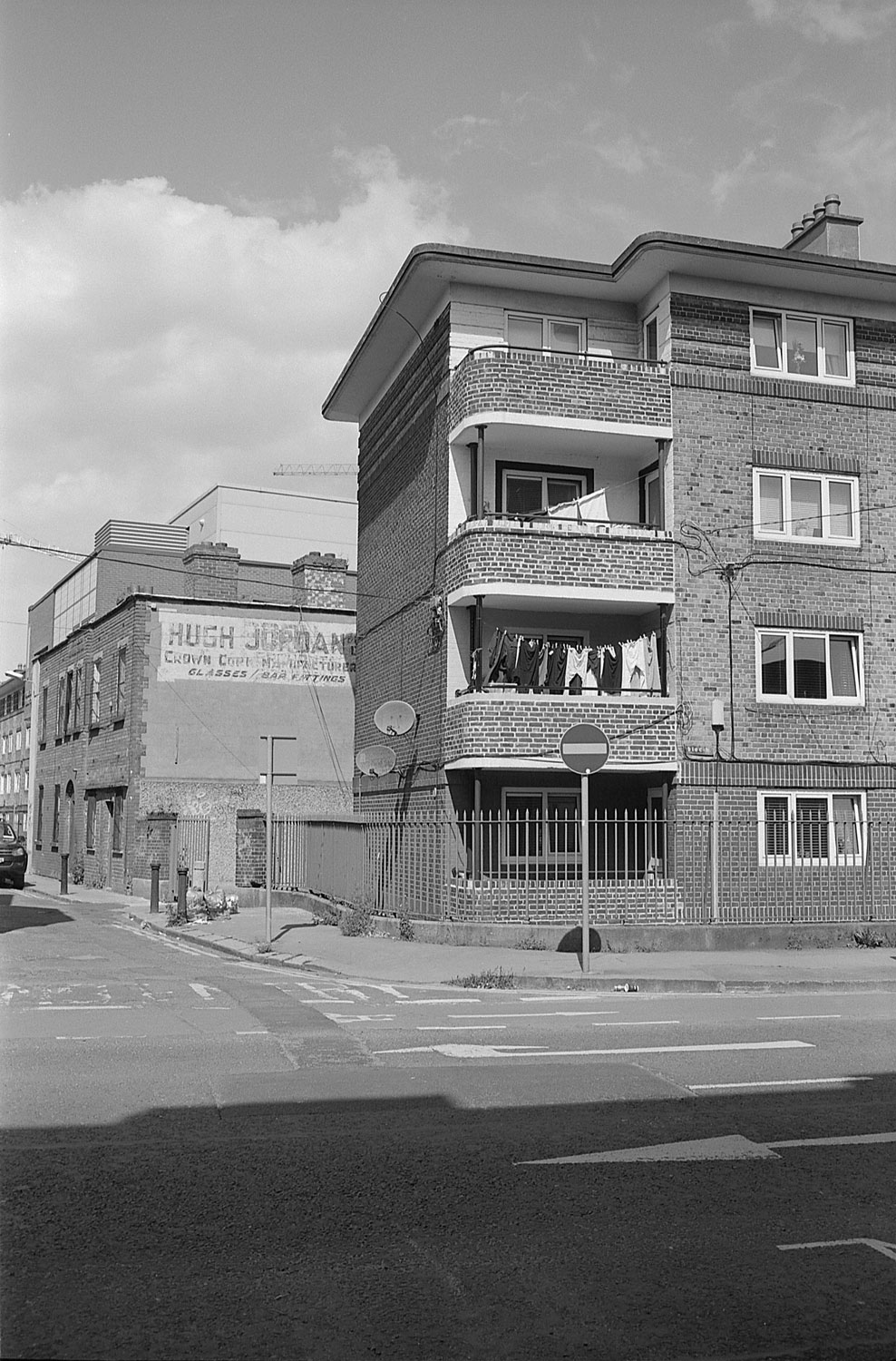

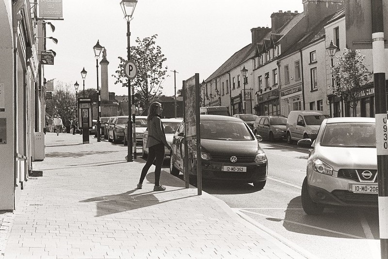

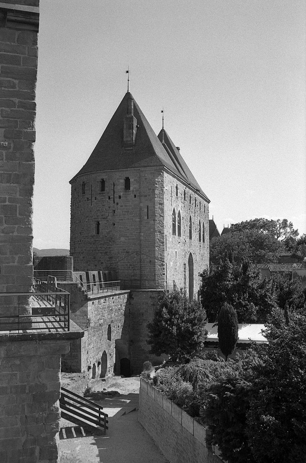

A lot has been said about skies and filters on this thread. Referring back to the original question. If you shoot a film with the right sensitivity and expose and develop it properly, you don't need a filter to get a darker sky with clouds. You definitely can use filters to good effect but they are not required unless you want a super dark sky.
No filters on any of these, first two Ilford Delta 100, last ADOX Silvermax. Leica M2, Summarit-M 2.3/35mm and Voigtlander Super Wide Heliar 4.5/15mm. First developed in one of my experimental PC one bath developers, second in XTOL, 3rd in my 2B-1 two bath (PQ).
Lighting here is: Ireland in June, Estonia in July, southern France in July.
View attachment 278014 View attachment 278015 View attachment 278016
Sorry but exposure and development have little bearing on it as long as they're in the ballpark because it's a about the brightness relationship between sky and stuff, any change in exposure or contrast will affect both, one can of course blow out the clouds, but blue will remain gray unless something extreme happens.
But I do agree one can get nice gray skies if they're blue and one shoots with the sun behind one's back, without filters, and I too find it hard to believe that the OP just did everything as usual and got a vastly different result. Shooting contre jour and light cloud cover are the usual reasons my skies blow out.
Brian and Brad - I rarely actually put anyone on Ignore, and only for a good reason. I just said, I should do so. No anger, no blood pressure issues. That's in your own imagination. Had a great day in fact. Or do I need to I say, "Pretty Please" every line. Some thin skins around here. Is there still any snow on the pass?
No, as you just yourself said, they have everything to do with it. If you blow out your sky (exposure tradeoff) or you increase development time to harden contrast (tradeoff) then you often lose clouds and get a white sky due to density.
Take the pictures you posted. In all of them, the blue of the sky is rendered about the same tone as larger areas of stone in the buildings or the cobblestones on the ground. If you were to overexpose or overdevelop so drastically that the blue sky was gone up the shoulder irretrievably (takes quite a lot with most films), the stone would be blank white, too. That would be beyond typical pictorial processing and what I meant by something extreme happening. In these pictures, as long as the scene on the ground is rendered more or less with a full tonal range, the sky retains tone. That's what I meant.
I think we're saying the same thing. In a high contrast scene you often have to trade off the sky for shadow detail in your exposure. Shadow which can sometimes be a large chunk of a scene. If you are losing your sky and the rest of your negative retains the detail you wanted, this was the tradeoff you made.
Then we agree. I guess I understood you differently because your pictures are not of such scenes.

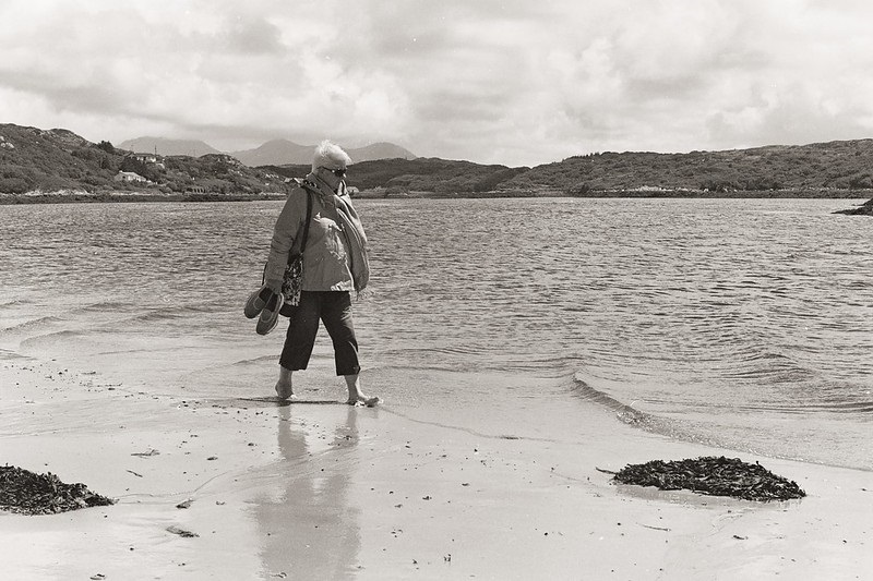

I personally think that you will get blown out skies if you have a high lighting ratio in the shot and you are trying to expose for the middle. Remember a ratio of higher than 1:4 was considered Film Noir look.
Here are two of my own shots.
Bright sunshine, exposed for person, blue sky had some clouds but rendered white.
Bright slightly overcast but sunshine (note shadow on water) exposed for person. Some cloud detail.
Yes, I agree. If there is a high ratio and the middle needs to be in the shadows, you lose the sky. In your first shot the person would have been shadowed heavily by the sun. So to capture that you have to give up the sky. In the second shot I think you are getting some filtered light because of more cloud cover and it's just enough to not blow out the sky.

Take a look at the third shot. This clearly trades off shadow detail.
A bit, but certainly not just for sky tone; the façade of the building is the same tone as a lot of the sky. Looks to me like you wanted overall contrast, it would certainly have been possible to get more shadow detail and keep the sky and façade grey, had you wanted that - but I think the shadow detail is perfectly sufficient and I prefer it contrasty like that.

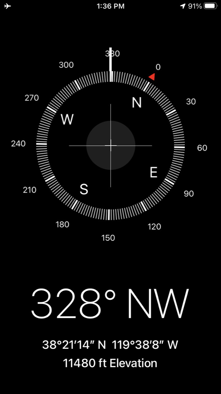

iPhone compass screen grab on Sonora Peak
