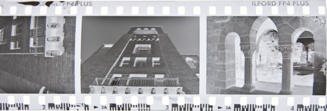

As Andrew O'Neill and jnantz have asked, can you show the negative, something like this, please?
