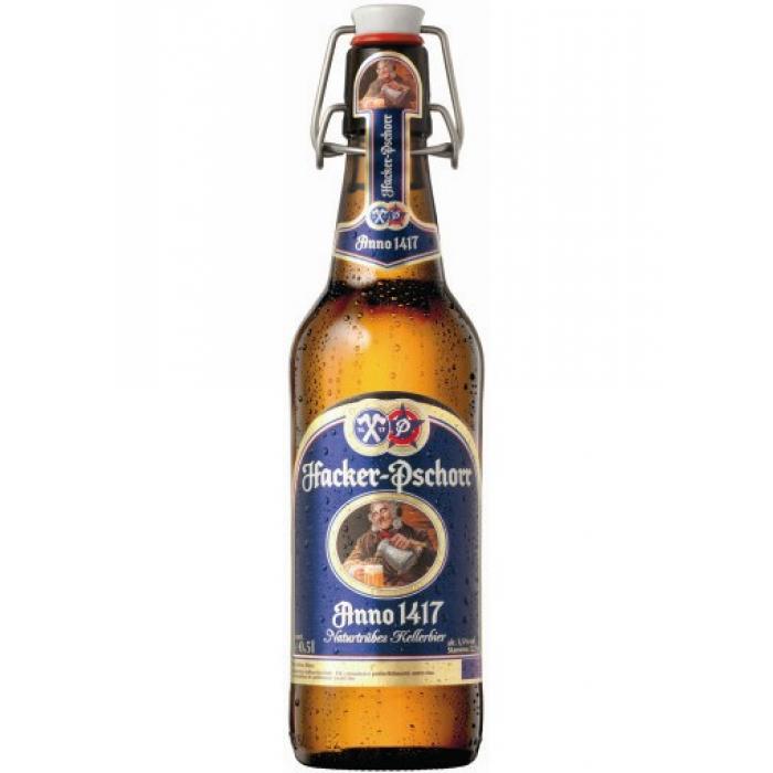

I bought yesterday this bear because of the cap and brown bottle:
I will store my chemicals in it. :smile:
At the OktoberFest does that bottle come in Kodiak size? It's the biggest bear I know of in a shade of brown:D The Kodak bear used to be the biggest but it has since shrunk. It is said to be due to its sudden shortsightedness and inability to recognise where its real food was :D
This is at least considered dangerous lab practice in Germany.
So be aware what you are doing and who in any case might get access to such a bottle. Being a commercial photographer higher demands on your safety practice will be put on you in case of an accident.

If you use common sense, there are no safety issues. Tape a piece of paper over the beer label (or simply scratch it off), use a permanent marker to make a crude skull w/ an X through it, and write POISON. CONTAINS (name of developer here) PHOTOGRAPHIC DEVELOPER. Perfectly safe. I now have the answer to my earlier post about whether to use plastic or glass bottles to store my developer in. Glass it is. Keep it simple. Thank you Agx and others.
While I'm no chemist, eons ago I used to work for O.S.H.A., and was involved in gathering information to present to Congress to have the P.E.L. standards (permissible exposure limits to toxic and hazardous materials in the workplace) updated and improved. If people only knew what goes on in businesses and hospitals! You'd be sure that people would be dropping like flies from some of the stuff I was told. But by and large, they don't. Over and over again I saw that solutions like Agx's were prevalent in the places w/ the best safety records, and that the "old ways" were generally the best. Maybe not the most convenient, maybe not the cheapest, but the best. As for breakage, wrap the bottle w/ a sheet of thin closed cell foam before putting your poison label on, and/or lay down a thick rubber mat where you use the stuff. Easier on your feet too.
There is no danger at all.
I label all my bottles not only to let others know it is not bear but also to let me know what chemicals is in each bottle.
I also used tape around the bottle so in case it crashs the tape will hold the glass pieces and chemicals in.
And if a child were looking for something to drink they would find many other things good and bad to drink before find my chemicals.
