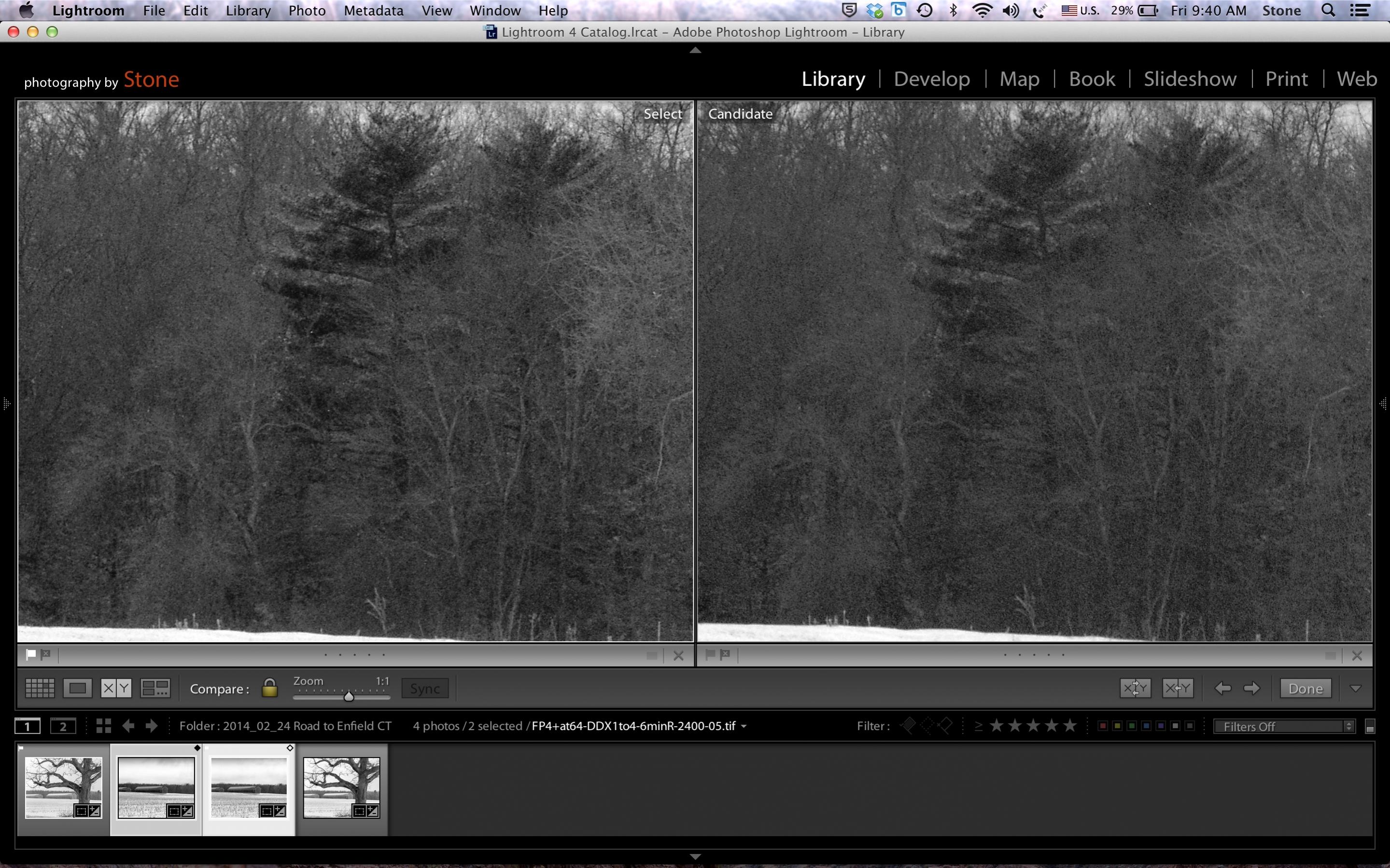

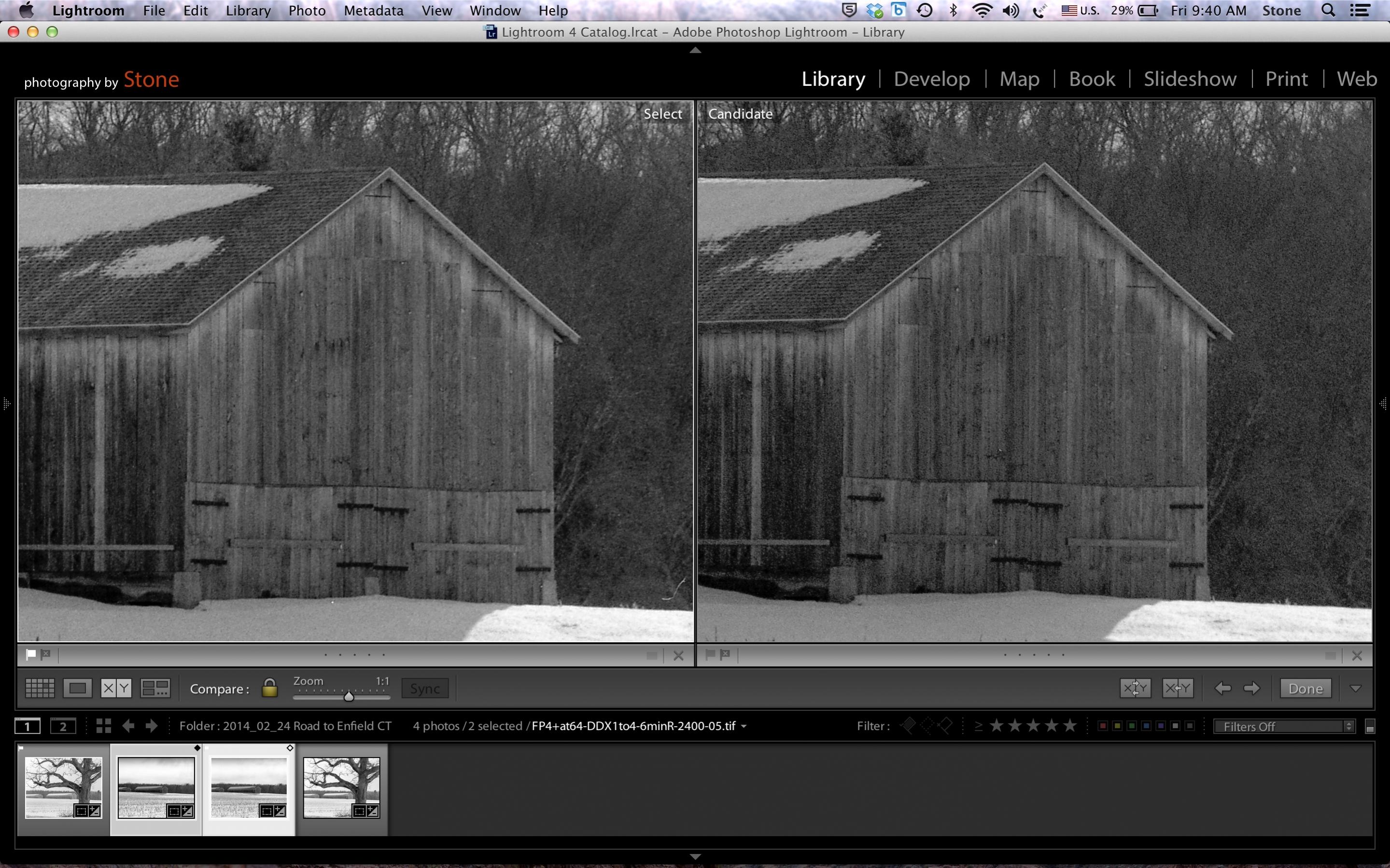

OK...so.... which is TMAX400 and which is FP4+? (EDIT: don't look at the file names... I forgot to make them blank...)
comparison-FP4+at64-DDX1to4-6minR-2400-04.jpgcomparison-TMY2at200-DDX1to4-6minR-2400-05.jpg
comparison-FP4+at64-DDX1to4-6minR-2400-05.jpgcomparison-TMY2at200-DDX1to4-6minR-2400-06.jpg
1:1
I'm not sure what you are trying to illustrate with your examples. It's hard to tell anything from the web, but if I didn't look at the file names, I would not be able to guess which image was shot with which film. The sample images you show look very similar to me. My interpretation is that TMY is just as sharp and fine-grained, and gives similar tonality to FP4+, while being 2 stops faster.
That is the conclusion I've come to also. I was quite shocked the first time I printed the two side by side of a similar subject at the same size. There was practically no difference visible. The main difference I see is in the reciprocity characteristics.

Nothing of value can really be illustrated with silly low resolution negative scans anyway. The excercise serves no purpose.
I love how I literally show examples and you say they are no good, then why don't you print a cropped image zoomed in to illustrate your point? How come I'm the only one willing to actually do tests and show my work...? And still everyone makes comments that it's not good enough.... This 1:1 is good enough for 20x24 easily bigger even... What does it even matter if it's a "low quality" or "high quality" scan? It illustrates that when shot similarly and developed properly you can achieve virtually the same result in grain and "LOOK" with either film. It does demonstrate what the above poster said that the Tgrain film could be shot 2 stops faster. But still can achieve the same "look" as a traditional grained film... Which was the question by the OP... Which I actually did the work, and showed my results... Unlike everyone else who just talks...
EDIT: what L said also that there is a difference in reciprocity characteristics which can be appealing especially for LF shooters with bellows compensation times etc.

Yep, that TMY-2 and FP4+ sure do look alike, which is my experience also. Confusingly similar.

The TMY picture looks like it has been shot through a light yellow filter. Different colour response.

(I got 1/2 on Stone's samples, by the way. The first pair I thought was pretty obvious based on the highlights, and I was right; but in the second I thought I saw the exact same difference, and I was wrong.)
