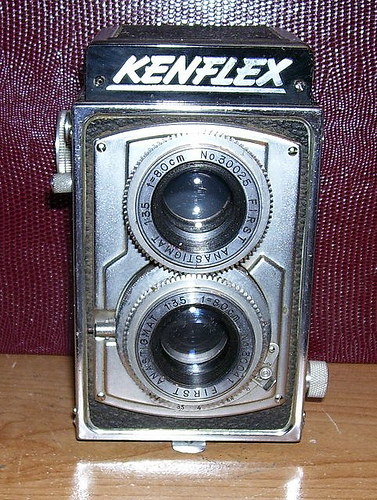

Obviously RF cameras are strange for common sense people. But for strange person like me...
Since this thread was open I acquired three more of them. Two as my first M were made, assembled in the province of my residnese, Ontario. Isn't it weird to like cameras made where you live? :smile:
Well, I had to buy a 'KEN-FLEX' in it's wooden case just because it was called Ken
Ken
