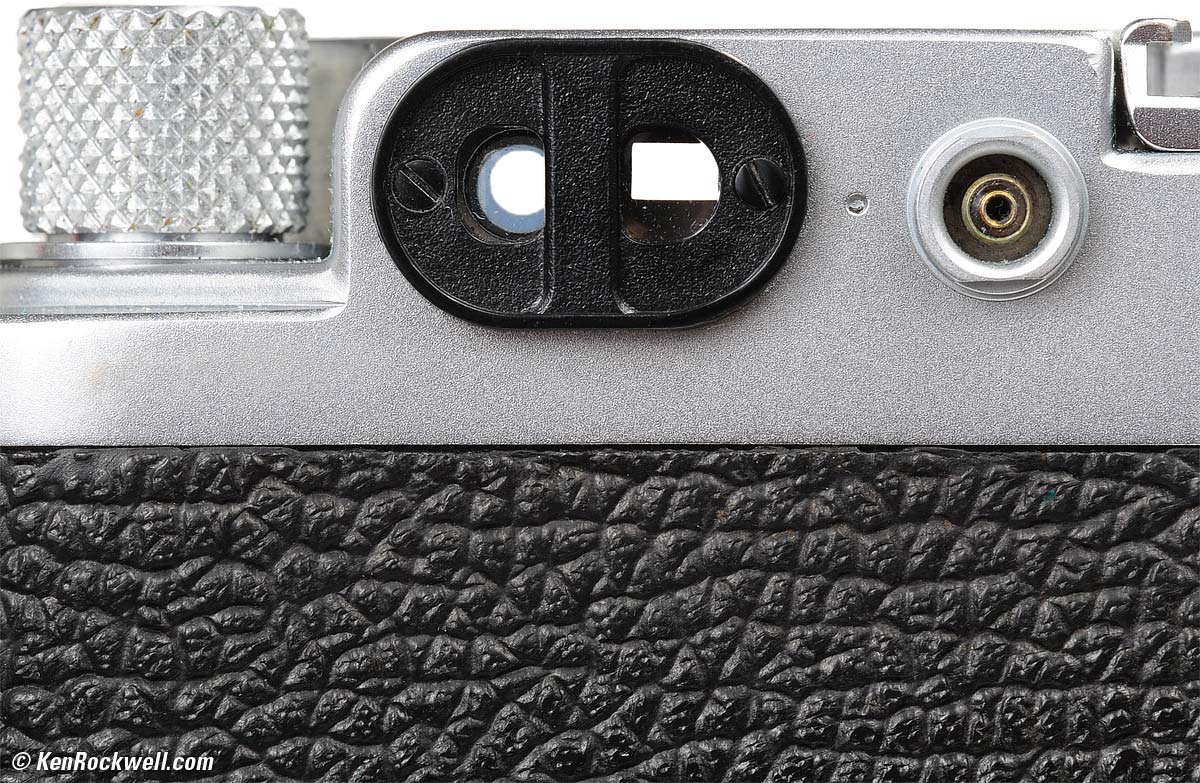

The design isn't simple, in particular the rangefinder is a sophisticated device with many movable parts that can get misaligned relatively easily and if it's so you won't find it out until you develop the film.
This is the rangefinder of a M3 and a M5:
Dead Link Removed
For low light applications I do NOT recommend a rangefinder because screwmount Leicas, Soviet copies and Canons had a dime patch, M have the bright one that sometimes "disappears" in low lightl...I miss more pics with RF than SLRs.

For low light applications I do NOT recommend a rangefinder because screwmount Leicas, Soviet copies and Canons had a dime patch, M have the bright one that sometimes "disappears" in low lightl...I miss more pics with RF than SLRs.[/QUOTE]
Can you explain what this dime/dim patch is? because I have never seen it on any screw mount Leica or any of the M series I am familiar with.
cuthbert
Nov 16, 2014
822
Have you ever looked inside one of these in night time?
