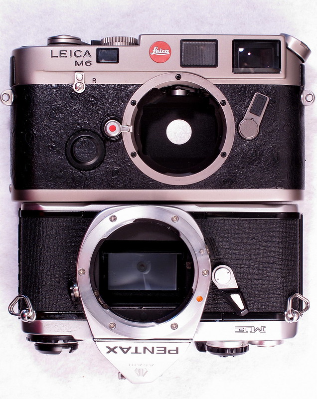

narsuitus
Nov 24, 2004
1,813
USA
The Leica M6 rangefinder and the Pentax ME SLR are two of my smallest 35mm cameras. When I need to carry just one lens and one small quiet film body, the Leica M6 is my first choice. When I need to carry one small expendable lens and film body, the Pentax ME is my first choice.
35mm film Cameras by Narsuitus, on Flickr
