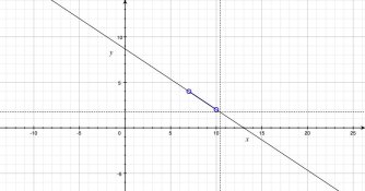

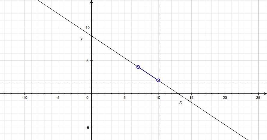

I am not sure how accurate this is. I just plotted a line graph on my computer.
I got y=a*x+b, a=-.6667, b=8.6667
Where y is the % of the mixture and x is the time. The points I used as my known points were (1+50)@500ml= 2% @10 mins and (1+25)=4% @11 mins
For (1+60) 1.7% the graph is telling me ~10.46 mins which is telling me my negatives should have came back black??
Thoughts?
~m
