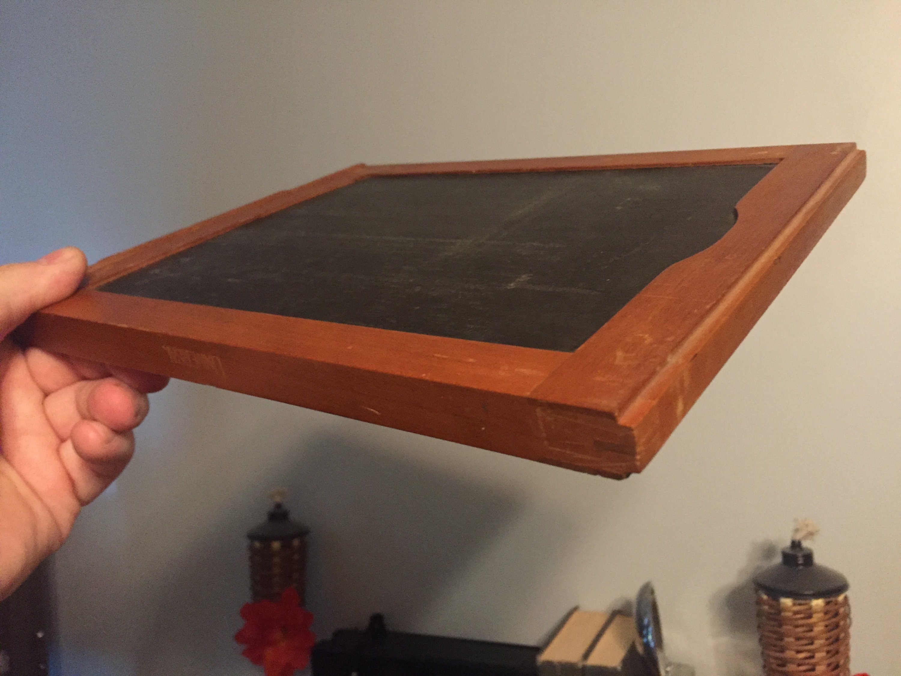

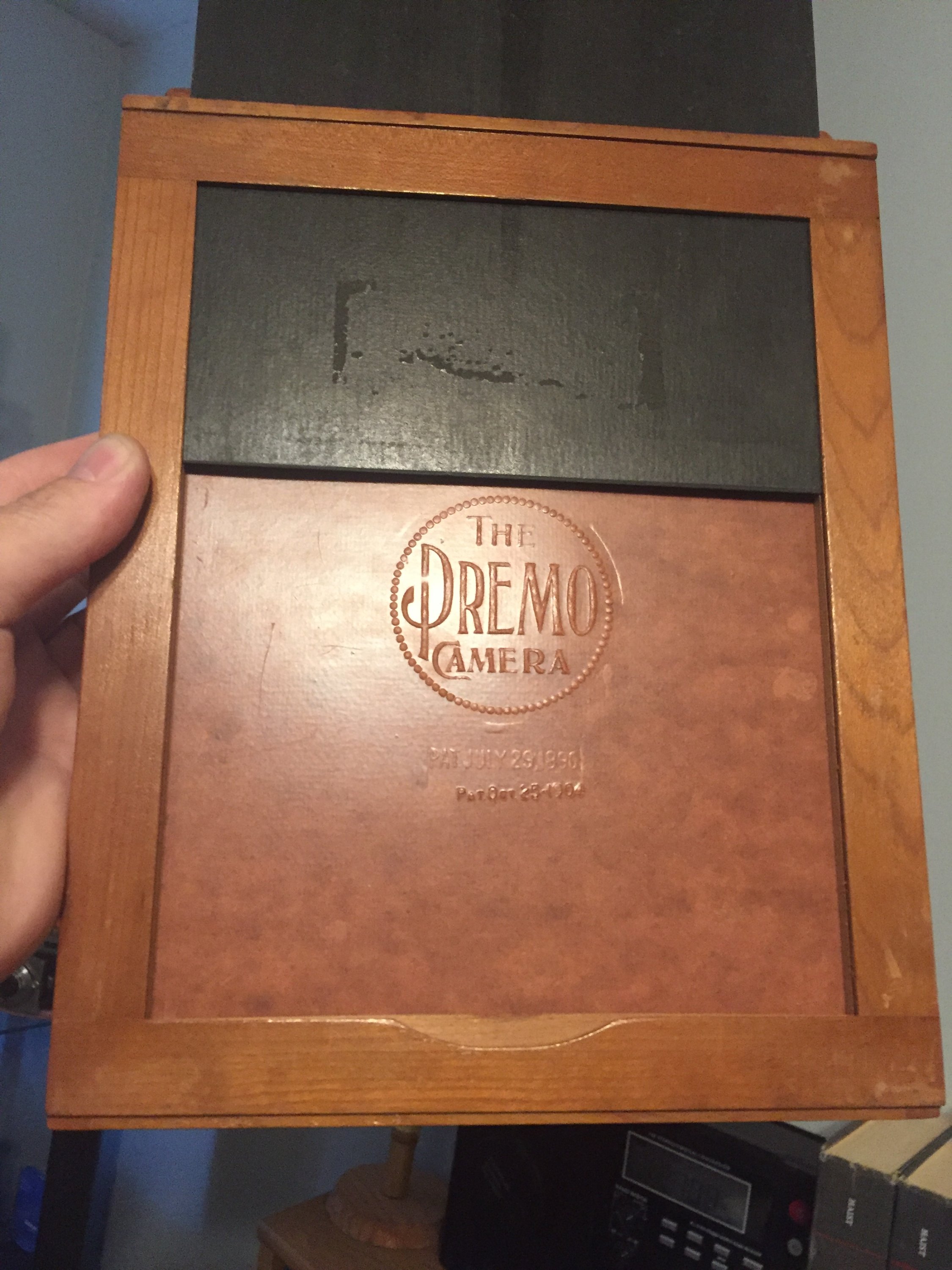

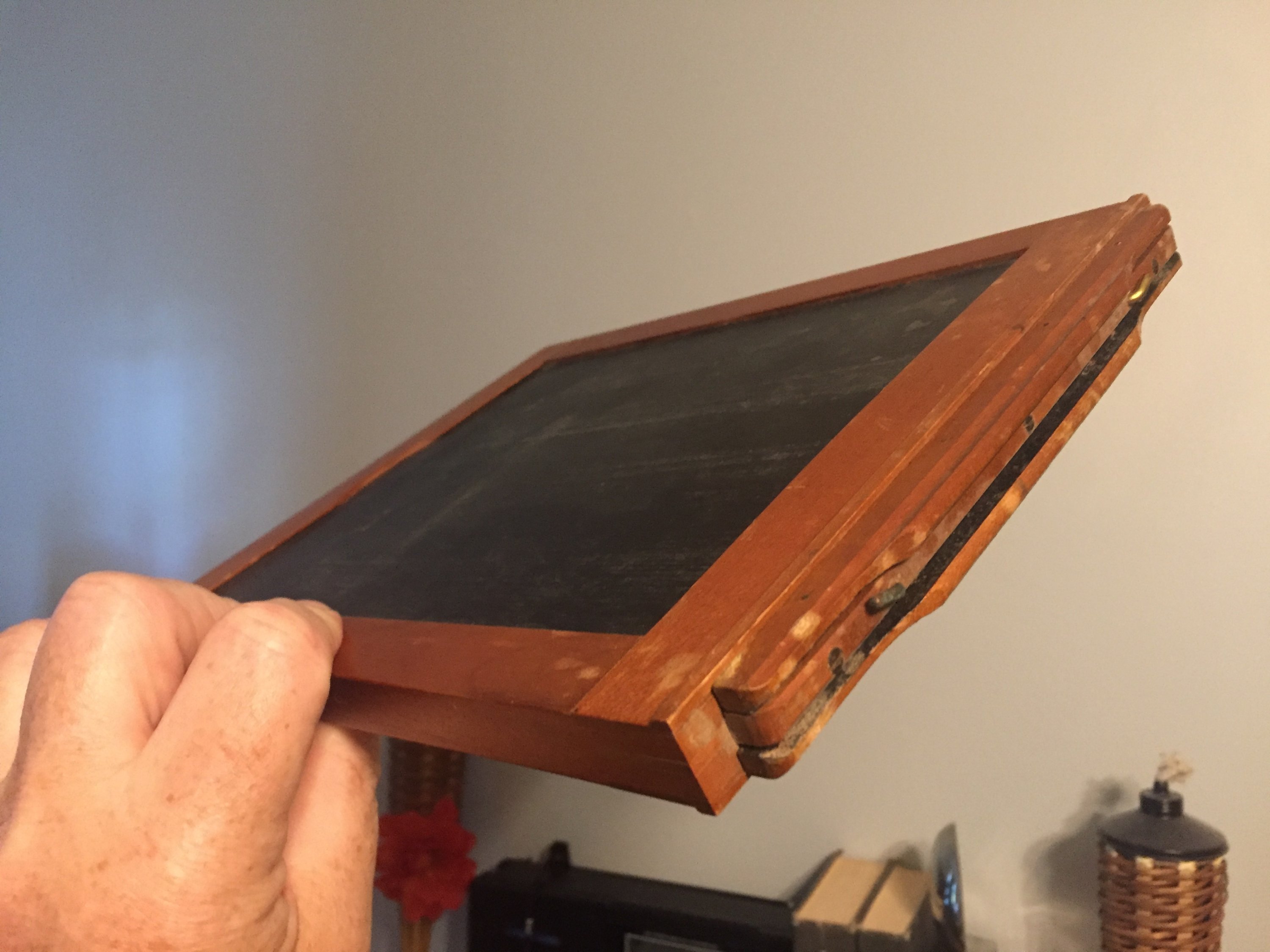

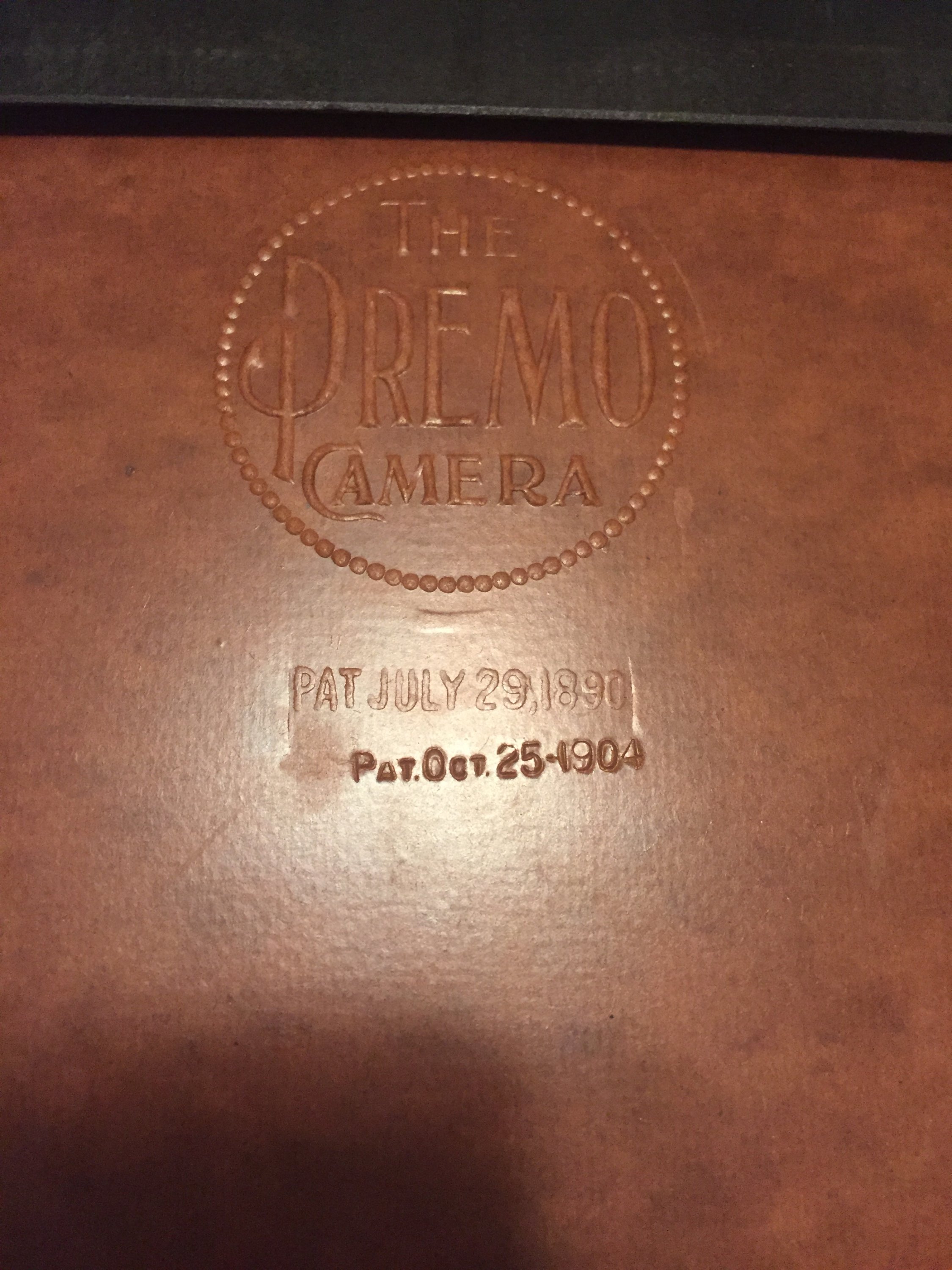

I stumbled into a pair of double-sided, Premo, whole-plate film holders. Of course, the camera didn't come with these holders, so I was wondering if they fit any other whole-plate camera, or are they proprietary?
They are not stamped "universal" as some I have seen online, nor do they have the brass pins as others seem to have.
They are in great shape, so (of course) I am thinking of tracking a camera down that would work with these holders. Yes, it's going at it backwards, but that's how it's happening...

8 3/8 inches wide (20.5mm) x 10 inches (25.5mm) to the stop on the top of the holder, tall and 5/8 inch (1.5mm) thick.
Opening for plate is 6 1/2 inches (16.6mm) x 8 5/16 (21mm).
Sorry for the crappy photos, I have a real light table with real lights and a neutral background slated for one corner of my darkroom/studio/computer room when it is finished, but until then.... crappy phone photos.

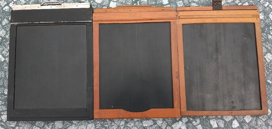

the stop rib is in a non-standard position, proving there is an exception to every rule. :smile:
I'm not sure when these DDS became more uniformly standardised.
These are all 5x4 DDS, first (black paint) Graflex, second Premo and the third one is the dodd one out Eastman Kodak 3 Patents marked inside two 1904 & the last MCH (March) 1906
The Premo states made by the Rochester Optical Division, Eastman Kodak Company and also states Patent 1904, it's odd that the Eastman Kodak holder positions the plates differently.
I wonder if that's to make the DDS holder slightly more compact to fit a case. I can't fit more modern DDS into the case of my Century Model 46, the Graflex plate holders are a tight squeeze.

Funny enough, that sure likes like the holder for Rochester Optical (or ROC, hard to keep straight) Universal camera and some others from that company. All of these companies were eventually owned by Kodak I think, but I was not aware of any Premo branded camera taking that holder; maybe ROC products were moved under the Premo brand at some point. Kodak made all the various sizes since they bought the various companies, but there is one Kodak size I think of as sort of standard. A right mess it is. I'll do some measurements in a bit.
