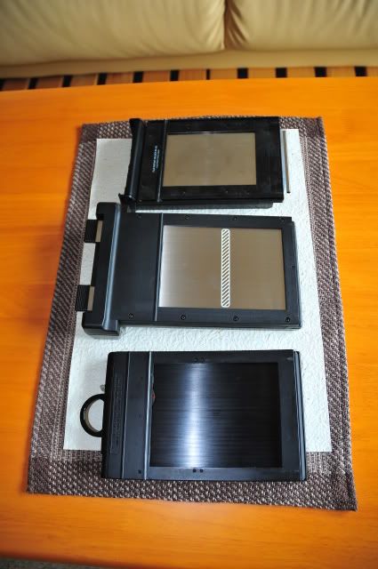

I thought I'd add a little help on the film pack types, how they look, and how they fit.
Here is a pic of 3 holders, the one on the bottom is a Grafmatic, the one in the middle is a Fuji PA-45, and the one on the top is a Fuji PA-145. The PA-45 makes a true 4x5 print, the PA-145 makes a smaller 4.24x3.25 print.
The instant film holders are put in the camera the same way standard film holders are. They are a lot thicker than regular 2-sheet holders, but not much wider than a Grafmatic.

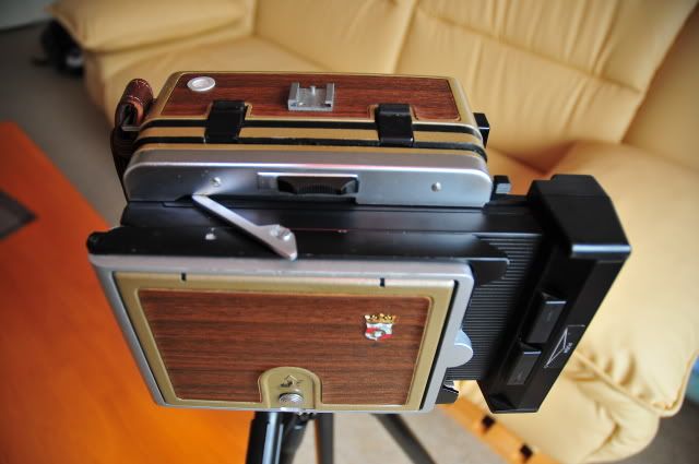

Here's my Wista with a PA-45 in place.

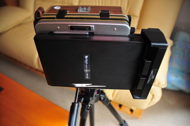

If the loader won't fit behind the the ground glass on your particular camera's back, you can install it like this, using the Graflok sliding locks (PA-45 holder shown).
The PA-145 (smaller model) works well for checking exposure, but the image on film will be smaller than the image shown on the ground glass, so you'll have to compose accordingly.
