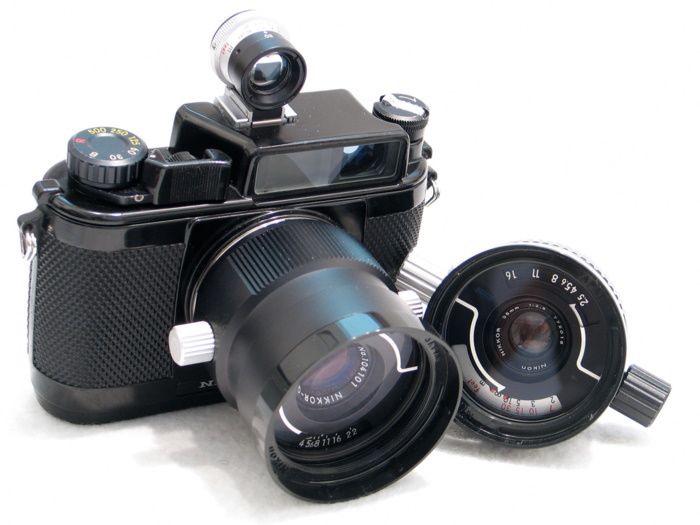

[http://www.flickr.com/photos/11336821@N00/5216154998/]

28mm UW Focus Test in Air.
This lens will focus very sharply in the center of the field, in spite of what one might read on the internet. The surrounding area (when wide open) is blurry. This is actually a cool effect and I shall use it to my benefit. There is some barrel distortion, as expected.
Focus Guide:
Infinity: aligns with "1 meter"
30 ft: aligns with "3 feet"
15 ft: in between "2.5" and "3" feet
10 ft: aligns with the "5" in "2.5" feet
7 ft: aligns with the "5" in "2.25" feet
6 ft: aligns with the "." in "2.25" feet
5 ft: does not align easily with anything
4.5 ft: aligns with "2" ft
