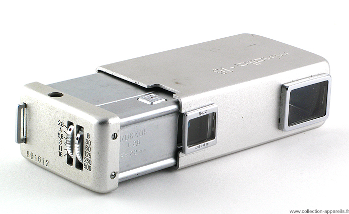

You have what appears to be an odd, mismatched combo there. The outer case is from a Minolta 16, the inner camera is a 16II model. I can tell from the small aux close up lens. Is the back viewfinder just a square hole?
Although I've seen several reference works say the Rokkor 22mm f2.8 is a 4 element lens, on a Minolta advertising folder they state it is a 3 element lens. Finally had occasion to disassemble the 22mm lens and all I see are 3 air-spaced elements. Close examination with a 10X loupe does not reveal any of them to be a cemented doublet. I think many writers assumed that when Minolta upgraded their model 16 from a 3 element 25mm f3.5 to a 22mm f2.8 they would naturally go to a 4 element design because of the faster aperture.

Good pickup. I just got that picture from the internet to show off the adjustable shutter speeds and f-stops; that one is not my camera.
