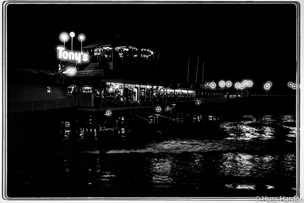

Nikon F6, Sigma Art 35 1.4, Arista 100, Cinestill DF96
Holy Halation circles batman! Arista 100 is awesome for that vintage B&W look. Great for high lit portraits too.
Modern emulsions do not have this glow. If you like this look, Arista gives it to you!

Fun! This is just FP4+ -- but I like the star effect I got with the street lamps..
Different beastie than halation, but still interesting...
Very cool! That effect is from your lens, and your lens does it really well! Most have wide/messy star effects stopped down. What was the lens? Aperture looks like at least f11..

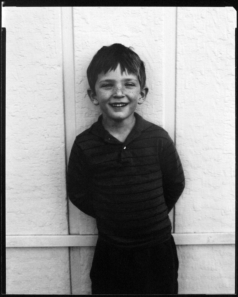

I've been interested in Halation ever since I saw some outdoor daytime fashion pictures that seemed to exhibit it. It's been suggested that those may have been shot with infrared. But my point is that I would like to induce Halation in sunlit pictures. Any suggestions?
MattKing
Apr 24, 2005
52,872
Delta, BC Canada
Backlight and some added diffusion will mimic it nicely.

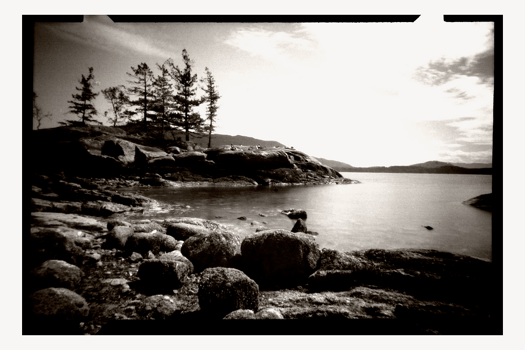

Pinholes also work:

Now that I think about it, those pictures were indeed backlit. What "diffusion" are you thinking of?
Backlighting and high key lighting will give that glow/halation look for portraits using Arista film. I don't think you will need to add any extra diffusion.
