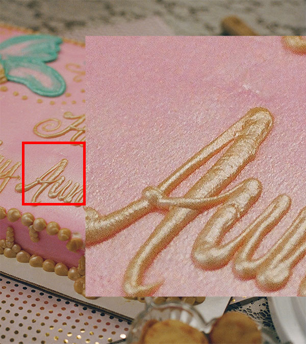

The point of all this is, I am trying to understand some artifacts I have seen in scanned color negatives from two different minilabs. My theory is, the artifacts are created by processing done to the output of the lab's scanner. But according to my local mini-lab guy, *no* processing is done to the scanner output. I'm pretty sure that is not correct, but I am hoping someone with more knowledge can explain what happens in a typical minilab between developing the negative and handing the customer a CD with scans of those negatives on it.
I hesitate to include this first one because it was an old roll of Kodak Gold 400 from the freezer, which may have had some adverse affect on grain. This is a 100% magnification crop (600x600px) from a 3637 × 2433 pixel scan (5.1MB JPEG) provided by my hometown minilab.
This is a 100% crop (600x600px) from a fresh roll of Portra 160; it's a 4492 × 6774 pixel scan (33.5 MB JPEG) done by Dwayne's Photo in Kansas. I don't know if Dwaynes uses a Fuji Frontier minilab, or something different. Despite the higher resolution (and much bigger file size), to me it looks no better than my local minilab results.
The grainy / speckled / reticulated texture is not present when I scan the same negative at home with my 18-year-old Dimage Scan Elite film scanner at it's maximum resolution of 2588 × 3622 pixels (27MB TIFF). I can't say for sure the two photos suffer from the same problem, but unless my home scanner is somehow masking the problem, I am sure the speckled effect seen on the second photo is not present on the negative.
Something looks over-sharpened to me, which is why I am asking if minilab operators have any control over how much sharpening their scan files get.

First off, you should be able to pull the type of scanner from the exif data in the scanned file
Secondly, I've had similar I think. If you push the sharpening slider in your processing software, does it just amplify the artefacts rather than sharpening the image ?
If so, yes it most definitely is a scanning issue. Due to the lab setting the contrast and/or sharpening levels too high.
It's one of the three common lab scanning errors I've had. The other two being halos between light and dark areas, and the scanner raising exposure/shadows to try to pull details from shadows that aren't there.
Try working with the lab to let them know what you want. Some people want scans that are optimised for prints and/or web use. Others (like me) want scans that are flat and unsharpened that you can then work on in post-processing software
Looks typical of a poor lab scan, a lot of them have baked in strange artefacts usually something to do built-in grain reduction processing or poor D-max/noise performance and resulting noise reduction algorithms. Some you may be able to turn off deep in the settings, the one I used to operate had a TIFF-OUT 16-base /MAX quality setting but even then the artefacts were still present at pixel level, you would never see these is a 4x6 or 8x12 wet print so the machine is fit for purpose.
Those look pretty typical of minilab scans. Keep in mind that your 100% view for the tomato would be a 10x15 print at 240dpi and the engine would be 18x24 at 240dpi. If you were to compare the two scans at the same print size, Dwayne's would look better, though I personally was not completely satisfied the last time I ordered scans from Dwayne's.
There is definitely sharpening applied to both. I believe Dwayne's uses a Noritsu scanner. One can control the amount of sharpening to a point but it really impedes the workflow to change settings for one roll and then change it back for the following. For the price you pay, it's asking a lot to stop production and do something out of the ordinary. These scanners are running the entire roll in the time it takes you to finish one frame on your Minolta. After having worked in a minilab for a couple years, I found that prints from these scans look better at about 2/3 or 3/4 the size of the 240ppi file.
The image below is a crop from a Portra 400 120 negative scanned at high resolution (4824x3533) at North Coast Photo on their Noritsu scanner. The enlarged portion is 600px of that scan.
