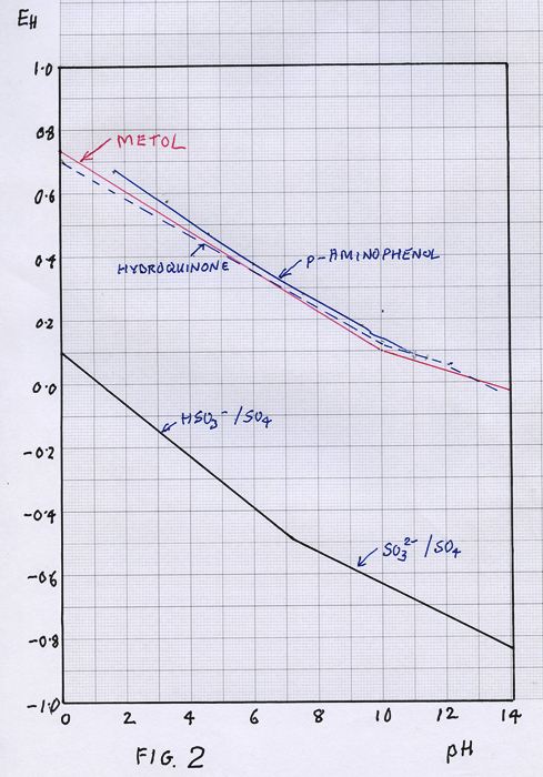

eh-ph-jpg.218402
On a Pourbaix diagram it is likely that the lines for ascorbate would fall below those shown for sulfite and it would be theoretically impossible for it to be regenerated by sulfite making it difficult to preserve. I have never seen such a diagram for ascorbate and it has likely never been measured .
If ascorbate ever fell below sulfite, it would be a fogging developer like dithionite, which it isn't.
I'm not chemistry minded enough to understand the diagram, but ascorbate is a very fog prone developer when at a pH high enough that it can work alone. Benzotriazole is the only thing that can prevent the fog that comes with it, starts to become active at pH 11, but only really becomes reasonable at pH 12 or above
