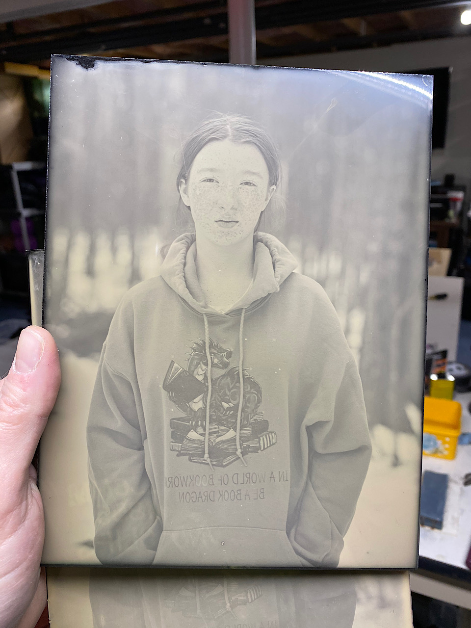

Lee Lira and I (mostly Lee) are working on a developer for silver gelatin dry plate ambrotypes. This is black glass coated with one of my emulsions and shot at ~ASA 32. Developed in Lee #2 test developer.

What exactly is the key to getting the ambrotype effect as far as development? I've gotten it a few times with experimental developers on ortho litho film and it's rather fascinating (though with film it never quite looks bright enough to me, can't get the backside dark enough). Key factors I've observed is under development and slight under exposure... but I never did enough with it to really know what would actually be an ideal developer for the effect.
as far as we can tell, the method I stumbled on leverages an interplay between dichroic fog, grain size, and reduction of the grain size in the emulsion. It’s pretty interesting and not the traditional underexposed approach like you mention. Highlights are very strong (dense?)
