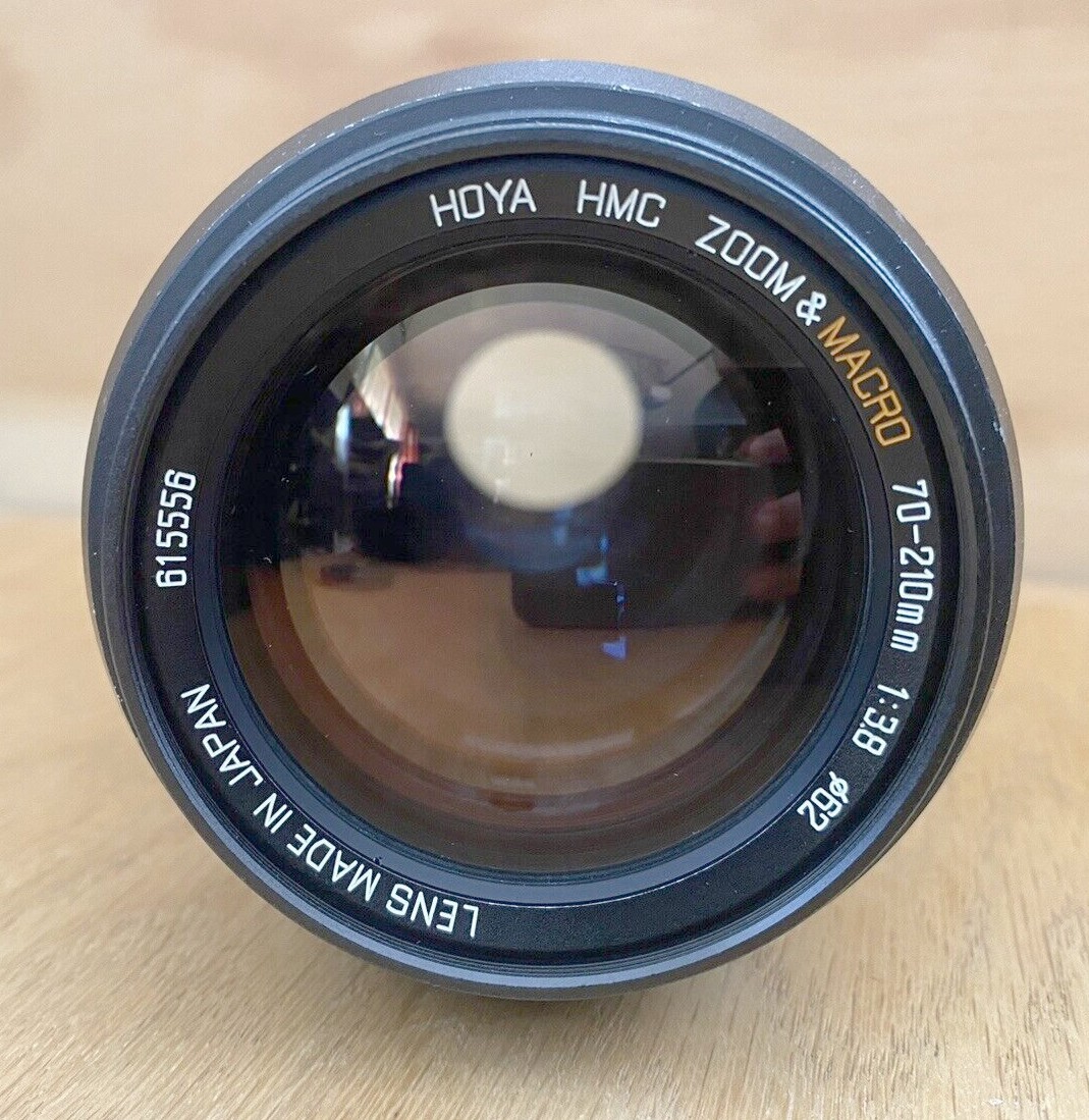

There was a time with some lens branded as Hoya existed. I saw them in shop during 1980s :
The rumour was like Hoya wished to enter lens making and not just filters. However the sales from market didn't go as expected. The lens is more likely OEM made and just put the name of Hoya, while the glasses are from Hoya.
Hoya made some other camera lenses are well, but I've never seen a list. They also made some lenses that were sold under other brand labels -- such as enlarging lenses.
