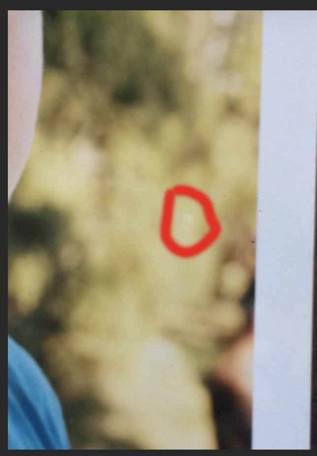

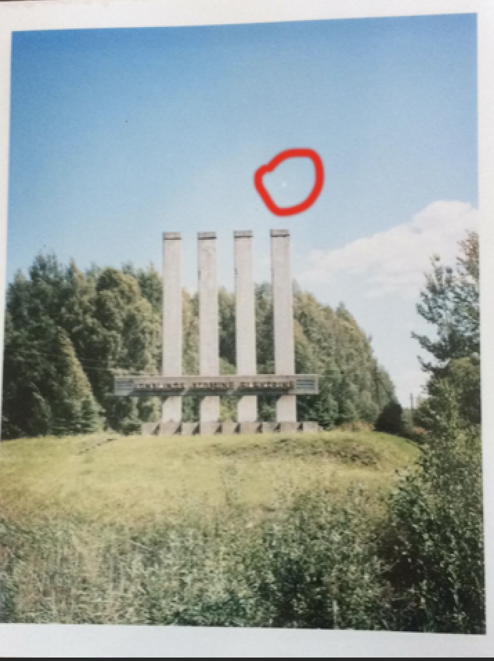

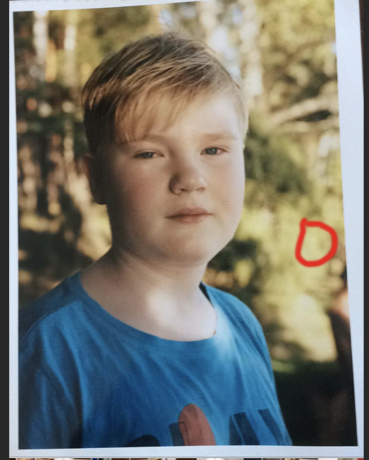

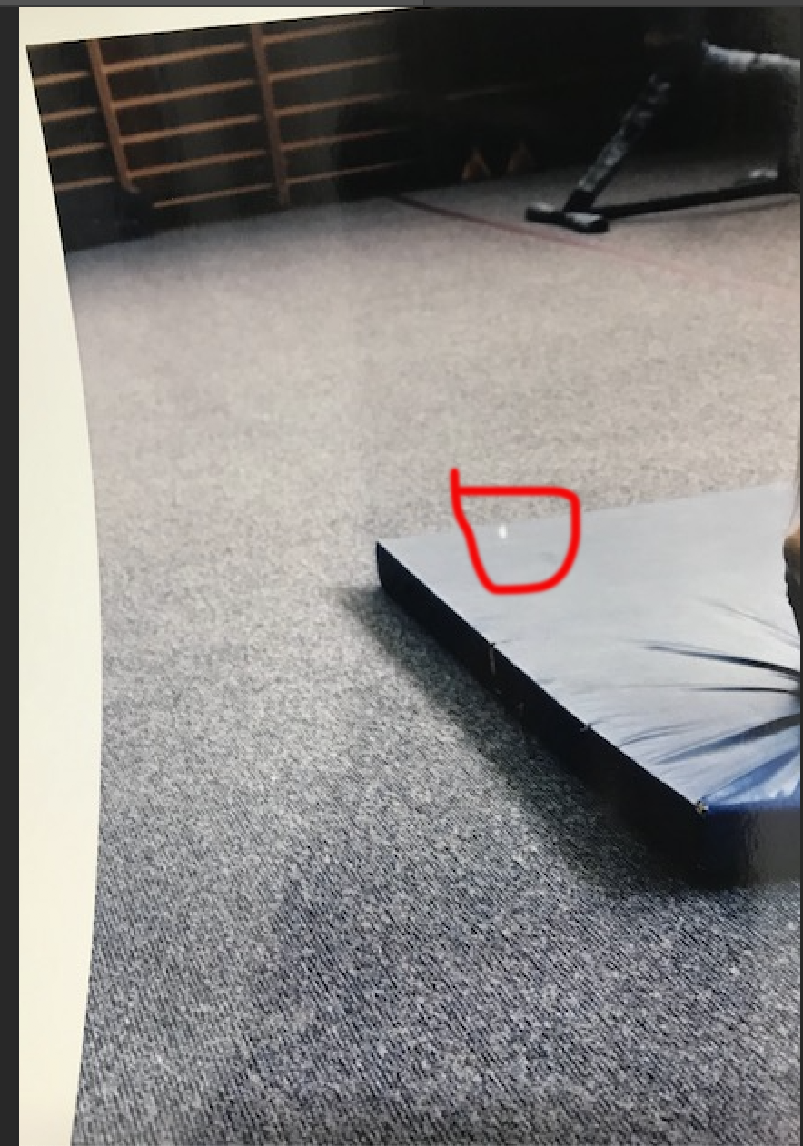

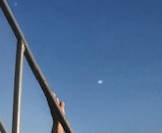

here's the white spot which is not on the neg but that I get on the prints using two differennt darkrooms/enlargers and lenses.
The type of enlarger is the same in both darkrooms : De Vere ( in one darkroom is the 504 and in the other darkroom is the 203).
The spot is always in different positions.
Sometimes it's camouflaged and cannot be seen, but when its on a clear surface or sky it's easier to detect.
If It appears on the sky I can turn the neg so that the spot is no longer on the sky but in the lower part of the print, hence less visible.
I'm ok doing that, but I was just wondering why that is happening and so my friend that uses the same public darkroom.
