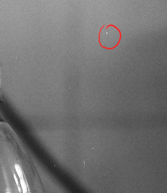

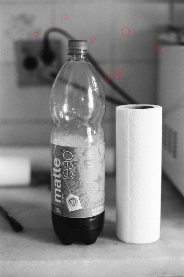

Just received from the lab (for scanning) my fisrt roll I developed 2 days ago... I really like the results (d76 - delta100) but I notice some white marks on the final image...
What are these?

I suspect it is dust or dirt which entered the emulsion while the film was wet. Try dusting the negs; even using film cleaner. If I am wrong, you are in good shape.

Yes as John say that's called dust. Scanning or printing with a condenser enlarger tends to really pick then up/out and there's not a lot you can do except *** can't say but the software has tools ***.
If you print or s*** the images yourself you can use a camel hair brush or similar and visually check/clean/re-check to minimise dust particles. But as soon as someone else is involved things change

I use a can of compressed air to blow the dust off the negatives and the flat bed before scanning.
