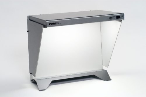

I have a Waveform NorthLux™ 95 CRI T5 LED Linear Light Fixture over my rinse tray. I have not noticed any afterglow. I have seen significant afterglow from LED bulbs, though. For critical viewing, I have a GTI desktop viewing station in my dry work area.

I meant viewing booth. https://www.gtilite.com/products/de...tions/pdv-professional-desktop-color-viewers/

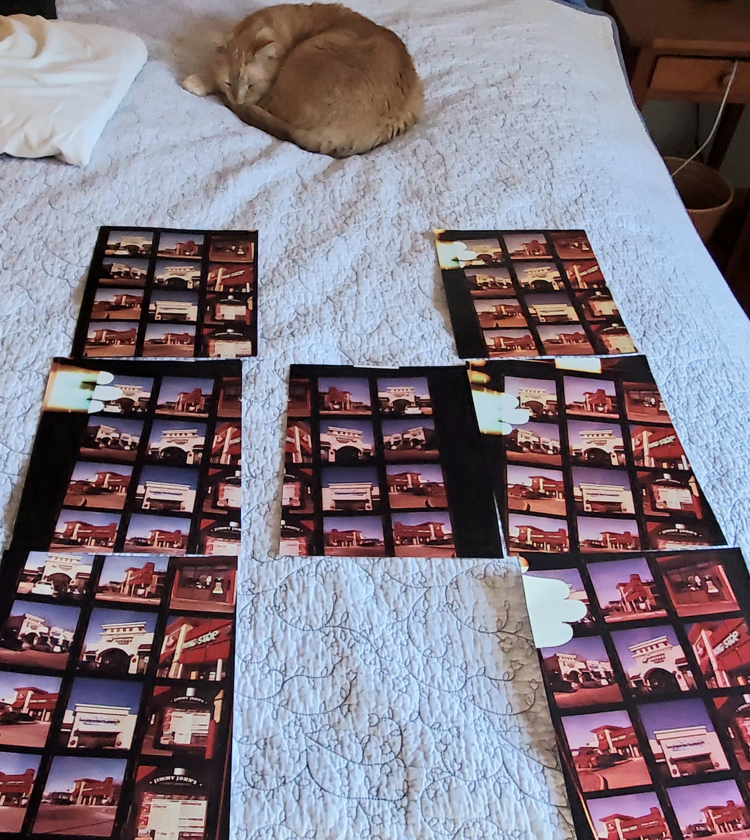

If nothing else I realize I need to print color often, or quit printing color completely. I used a company light booth, no longer available since I left. "Color People" who evaluate color for a living are amazing. My cat Gus is not impressed :D
As an art director, I regularly evaluated color, both at the proofing stage and on press. It can be quite stressful, and one must come to terms with the limitations of reflective, CMYK color rendering and the practical aspects of printing multiple images in signatures on press.
This was another quick "test roll". Ektar is so saturated, winter light here doesn't help. I need to stick to Portra :smile:

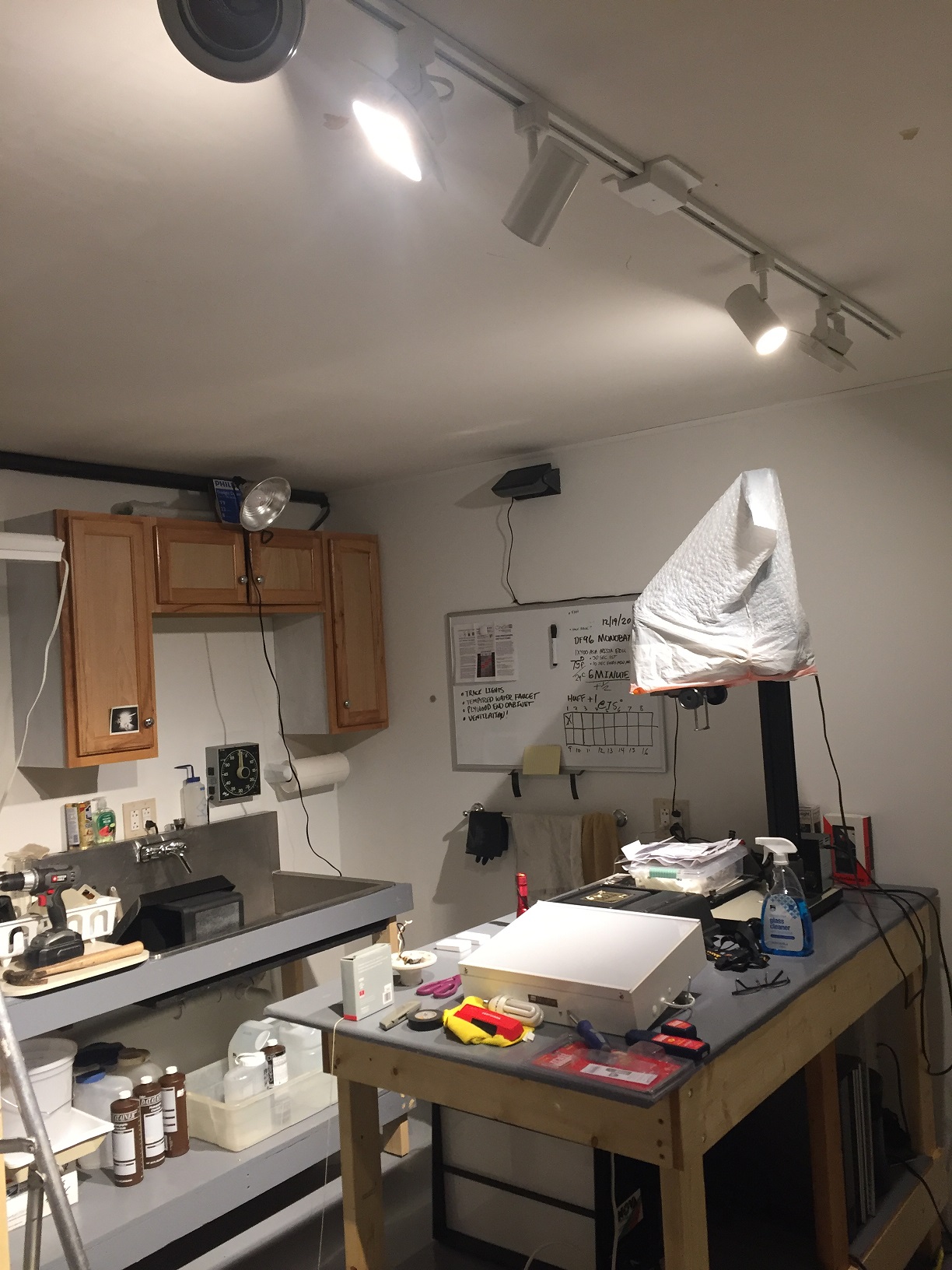

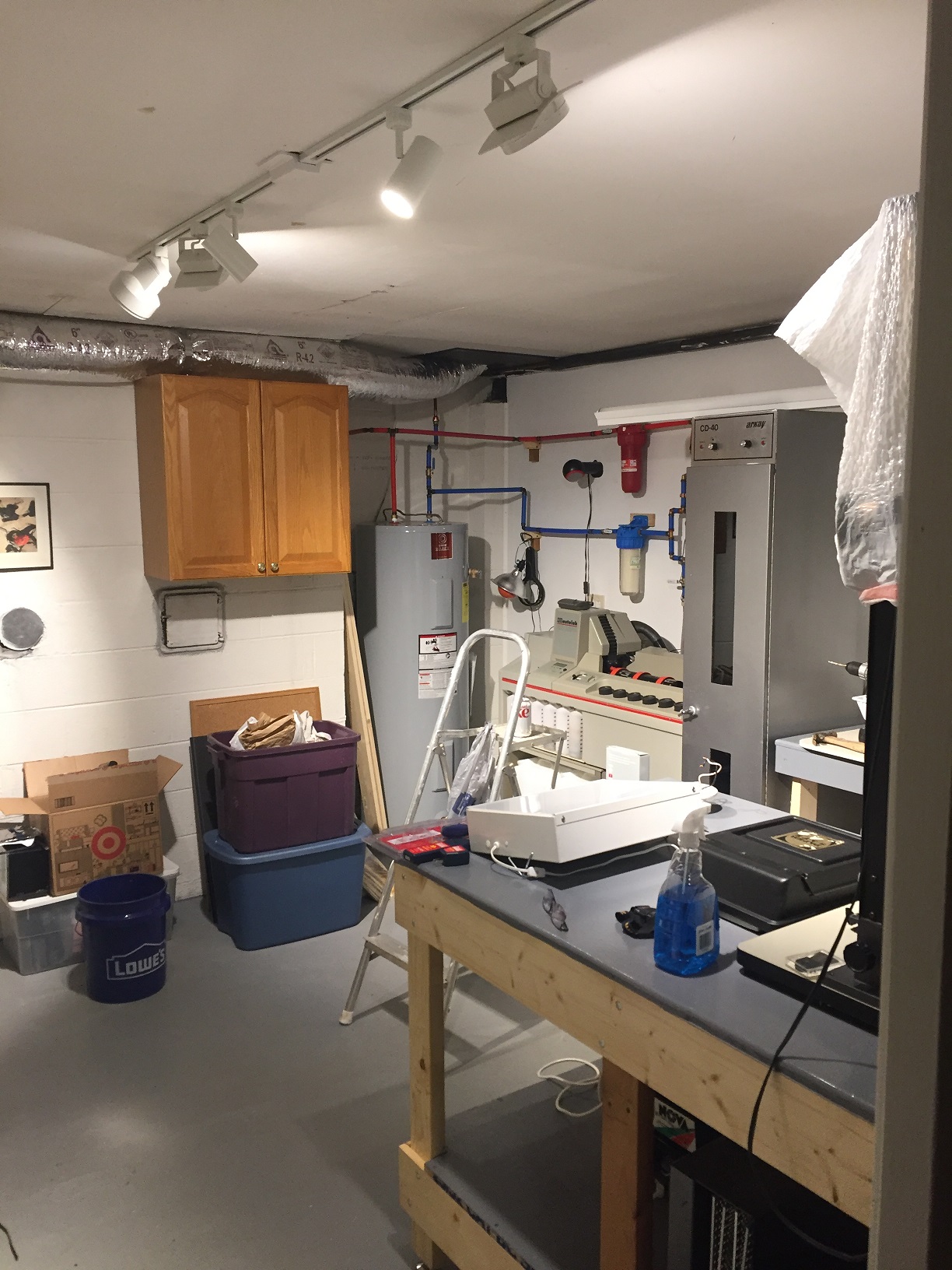

Ran home and installed my track lighting. Tested it and there is only about 1/2 a second afterglow, so I am happy.
Really easy to install.
