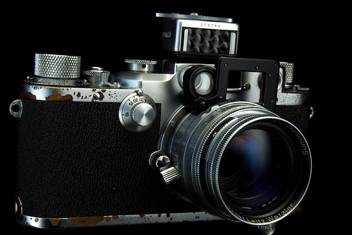

Leica IIIc with NOOKY-HESUM. Make sure to get the correct NOOKY for your lens. The NOOKY-HESUM works with the Sumitar lens, there is onother NOOKY for the Elmar lens.
Leica IIIc with a Summitar lens and Nooky-Hesum Closeup Attachment by Bryan Chernick, on Flickr

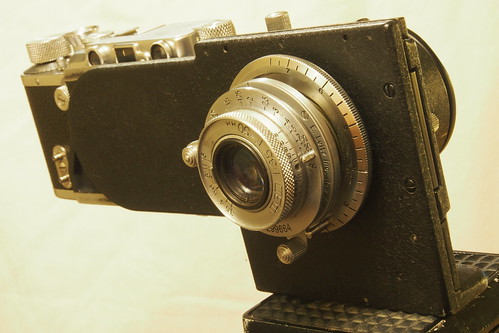

Leica IIIa with Focaslide. Focus with the ground glass then slide the camera to the lens to make the shot.
Leitz Focaslide by Bryan Chernick, on Flickr

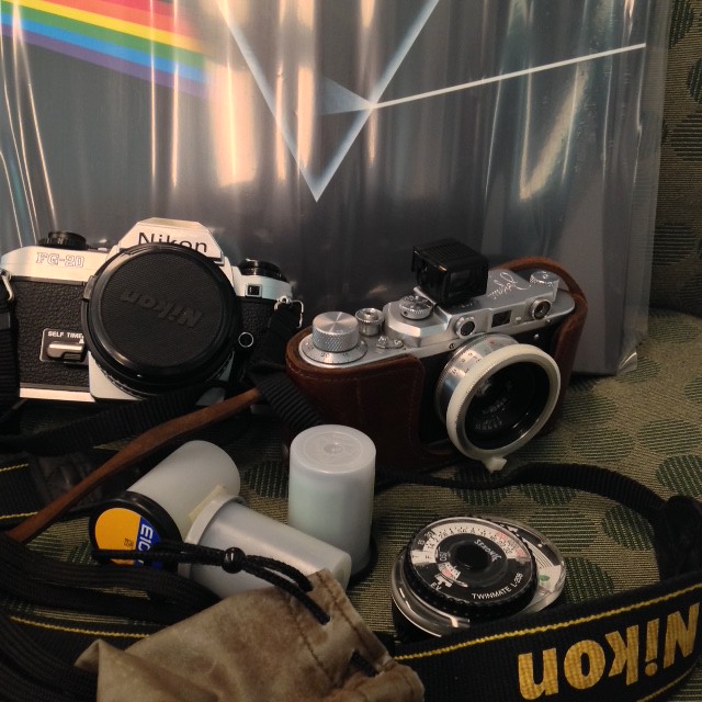

OP asked about kit for travel. For stills and macro on travel and stay light I recommend small camera like Nikon FG-20 SLR and Nikkor 55 macro lens. No tripod might be needed, if bw film is pushed.
If tripod to be added, then SLR still wins for landscapes with TS lens. IMO.
