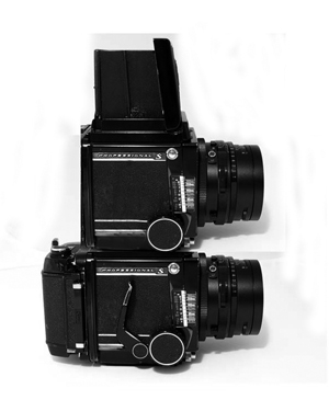

How about this one ?
Ok, it has not been made jet and is the idea of Keith W and me, but still...
The ultimate TLR 6x7 ?
Peter
