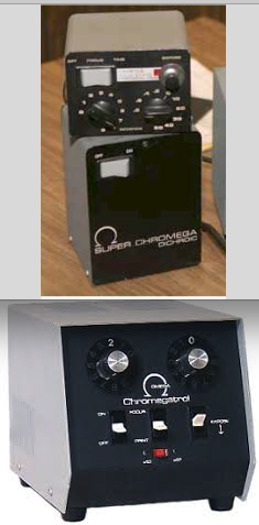

I think these are the only two power supplies available. The non-regulated power supply can run with any timer, but the Omega Precision Timer sits on top and is a good choice.
