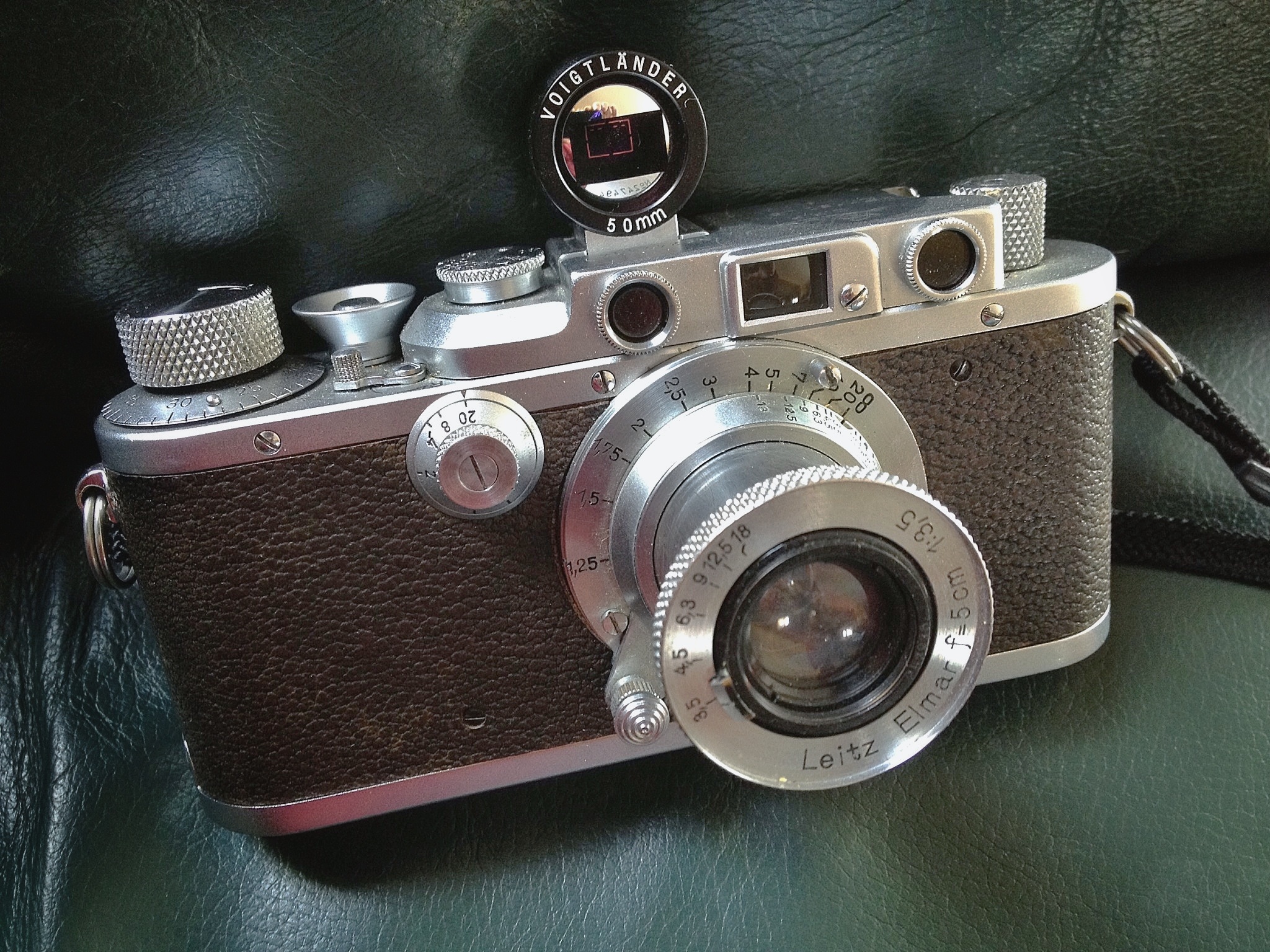

I guess Frank's brain works faster than mine does (whut a surprise at my age) but a finder would do wonders for your squint problem and the 3f, although also hard to load, is -- well, a Leica.

Here's mine.
