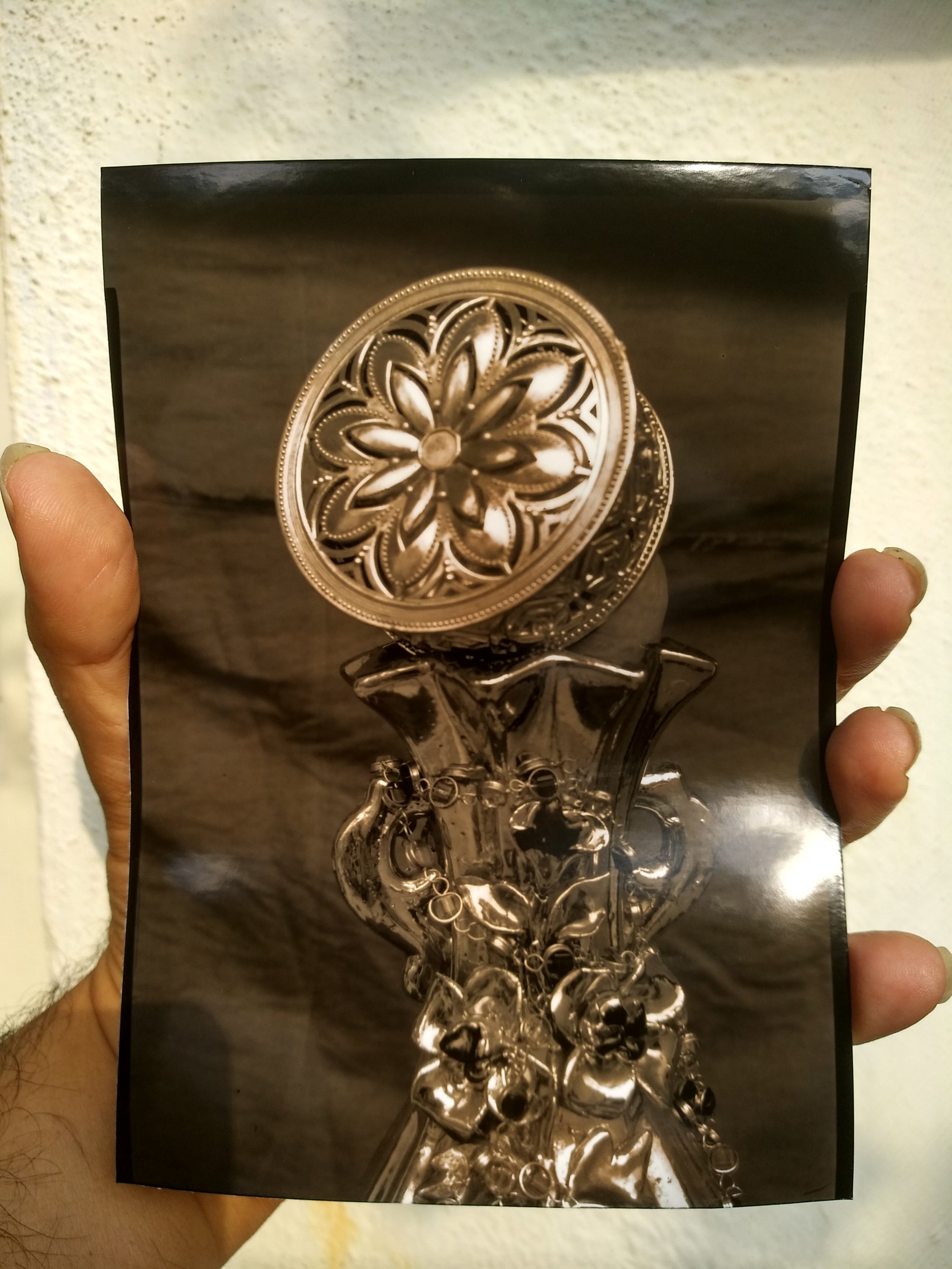

Not sure if this qualifies as alternative process, but it surely meets the criteria you listed: reversal processing of paper. Essentially, you put a photo paper in your camera instead of film, expose it as it were a slow speed film and then reversal process into a print.
Here's a basic reversal process:
https://www.photrio.com/forum/threads/paper-negative-reversal-process.74130/#post-1029646

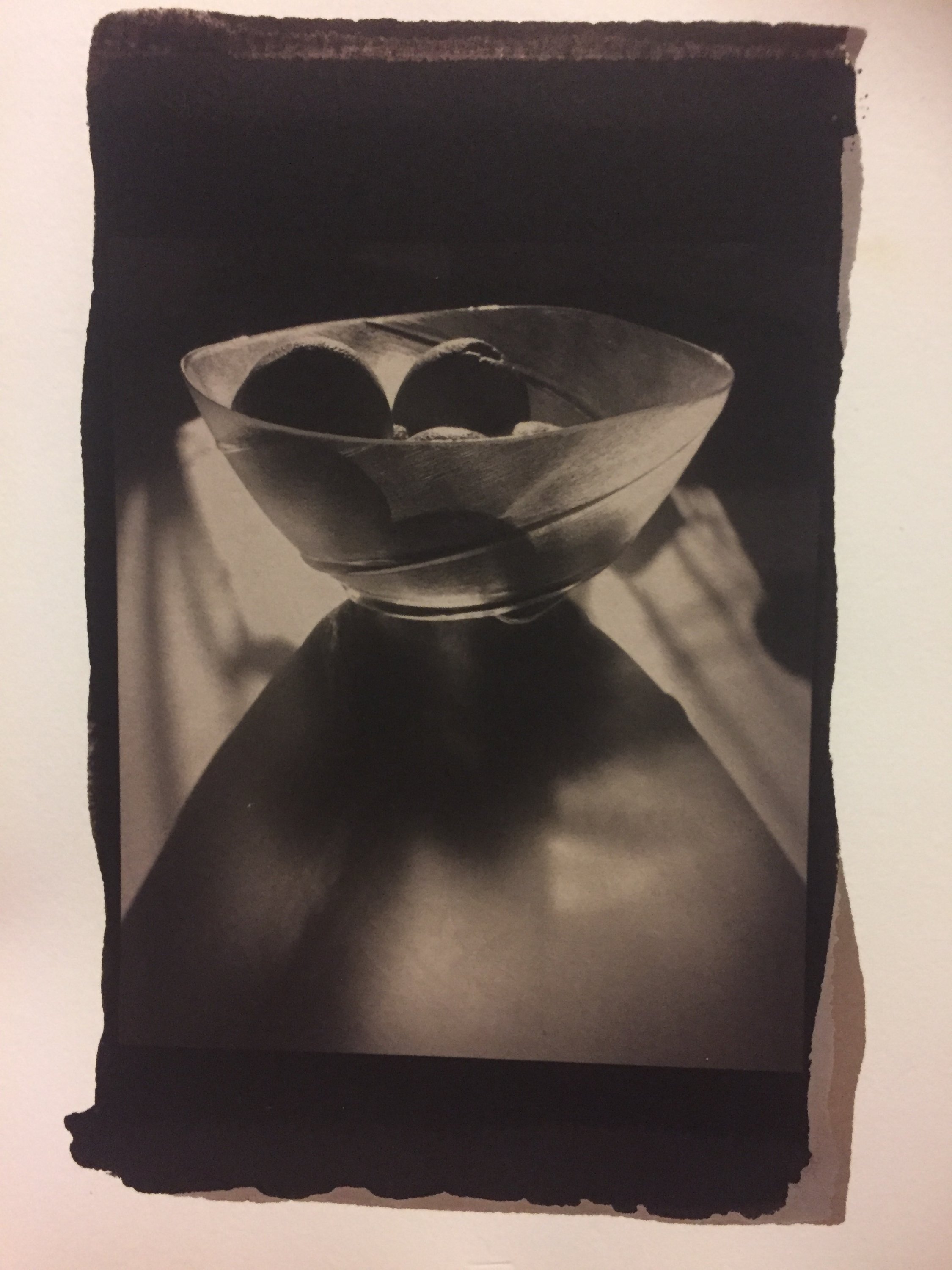

I can't speak for the other processes but once I saw a real live pt/pd print that was well done I was hooked and wanted to do them as well. I can't say that it is inexpensive beside the chemistry you will need negative material to enlarge to ( a 4x5 can be very effective --Pictorico Ultra Premium OHP or x-ray duplicating film), paper, a good brush or puddle pusher, a printing frame, a shot glass, preferably dedicated trays (5), a tray siphon and uv light source. I started with the sun but quickly bought a uv light box. I get my supplies from Bostick and Sullivan. They are in Santa Fe, NM. They carry all different "alternative"supplies and can answer any questions you may have. I think they also can lead you to a workshop which would probably be the best way to go especially if it is a hands on so the chemistry etc is supplied and the cost would be that of the workshop but you would also be getting information.
