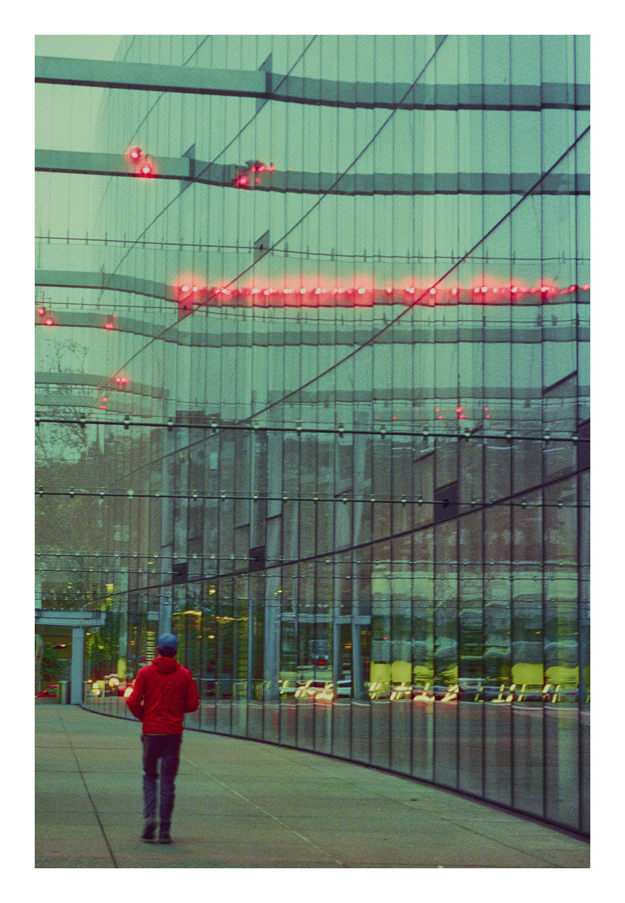

This was shot on Cinestill 800T that I rated at ISO 500 and had it developed normally. I may have even added a little exposure compensation but I don’t remember. I think the red in the jacket is still a bit muddy and I don’t know how well this would print. I cropped it and heavily manipulated the colors in Capture One.
I’d never shot Cinestill 800T before and I think it turned out nicely. I look forward to doing it again sometime.

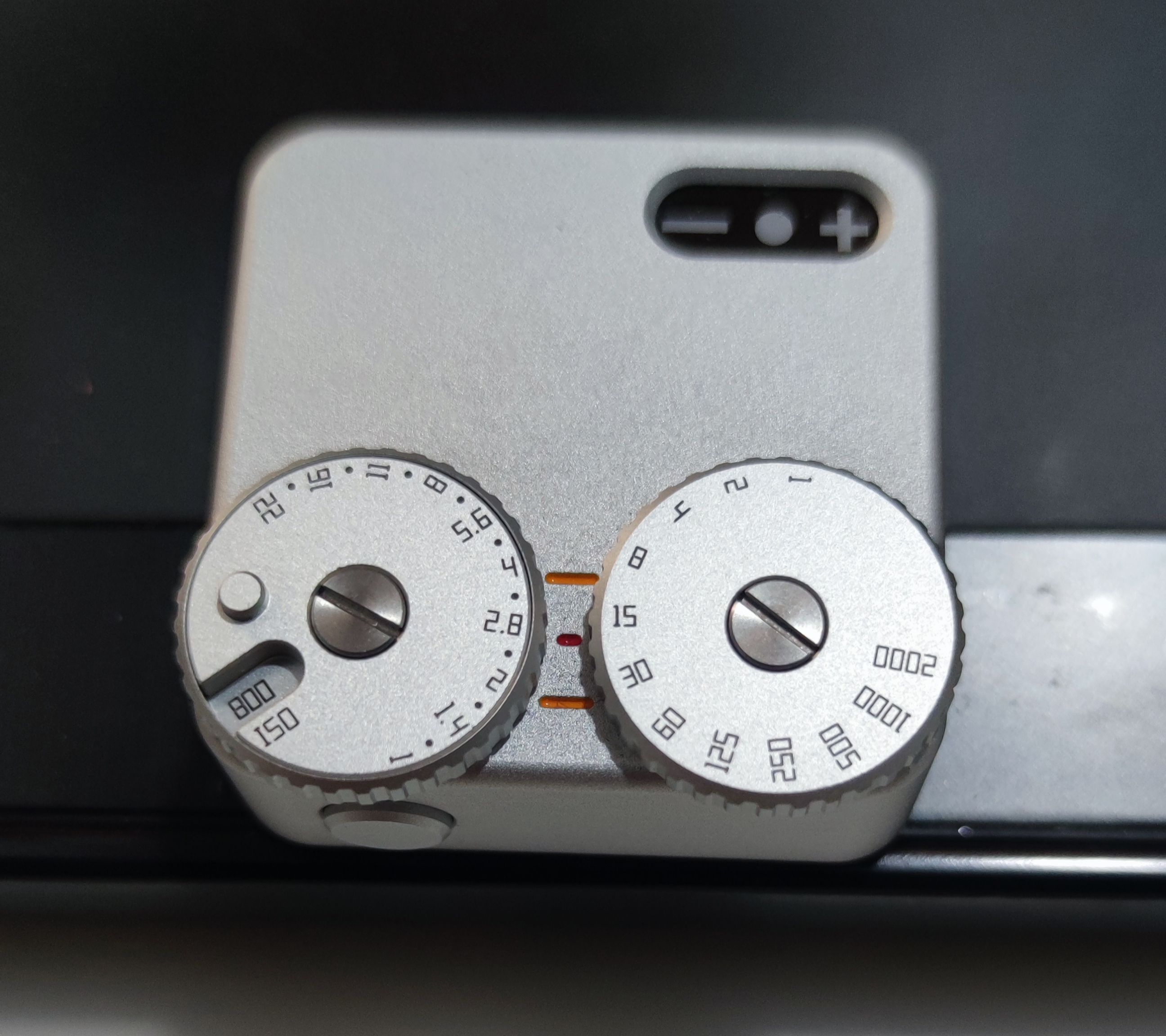

I do not really insist on using a light meter but why not if it eases the whole process instead of doing something that I would consider approximate? It is just that I have absolutely no idea how to do without but yes, I could try to set the lens at F/2 with shutter at 1/60 for example and see how it goes since I do not know when exactly shaking starts to be an issue according to the shutter speed.
Here is a picture of my lightmeter

1/60s :wink: Do you come from digital or do you have really fast lenses? You will most probably have to go way bellow that to capture some of the ambient.
That looks like a reactance meter that you use on your cold/hot shoe? Does it come with a manual where you could learn what area (angle) does it use to read light?

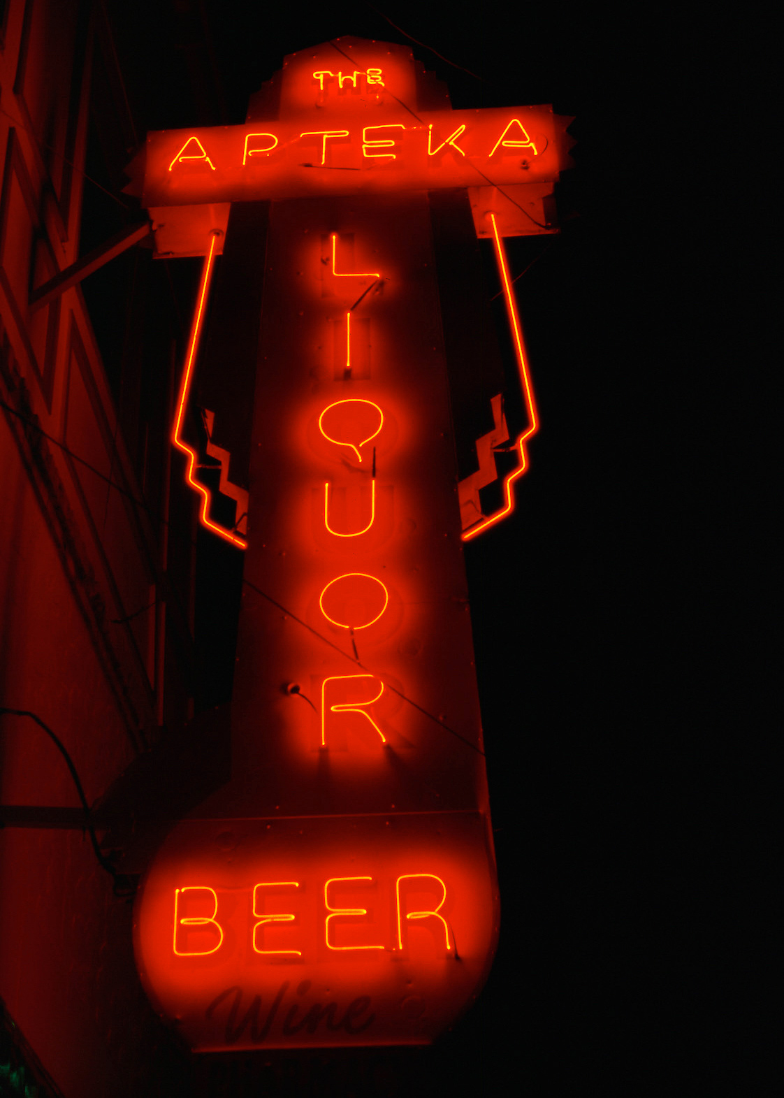

Yes, since you have one, why not use the light meter?
The first question, is what ISO/EI to use? We have already discussed that. Anytime you are new to a film, I suggest starting with the "box speed" ISO. Others will tell you they always expose their negative film at some EI lower than the box speed because, generally speaking, over exposure is preferable to underexposure. You may want to do that with your second roll, depending on how thick or thin (dark or light) the negatives from the first roll are. When you pick up the negatives from the lab, ask the lab to give an opinion about whether the negatives look properly exposed. If they say the negatives are too thin, then choose a lower ISO for metering the next roll - try something like 500 rather than 800.
The next question is, do you want to meter "normally" - that is, do you want to set the camera to what your meter tells you? - or do you need to "compensate" by increasing or decreasing the camera settings compared to the meter reading? This gets a little tricky, for several reasons. In my experience, I usually do not compensate. That is, I just used my camera's built in meter reading. But my experience was using slide film, not negative film. Furthermore, my photos were intended to show only the neon light - but the examples you link to show a lot more of the environment around the light, so you may want more exposure than what your meter says(?) Hard to know until you try it.
As for shutter speed, in my experience, using a 50mm lens, handheld, I have to pay attention to avoid camera shake at 1/60th sec. By "pay attention" I mean squeeze the shutter gently just after exhaling. Others will tell you they can shoot handheld at 1/30th, but I'm not one of them. At 1/30th second or slower, I would recommend a tripod and a shutter release cable. But if you don't have a tripod, then it is sometimes possible to find a substitute in the environment. Look around for a sign post, hand rail, or wall you can brace against, and sometimes you can get good results at 1/30th, 1/15th, or even 1/8th second.
In this example (slide film) notice the straight camera meter exposure resulted in the background being quite dark.

It is indeed a meter to set on the cold shoe and here is a picture from the manual but no much on it.
That meter is pretty primitive. It will be like having a compact camera with simple average metering mode and angle wider even wider than your lens, no fancy matrix metering, no option to selectively meter the scene...

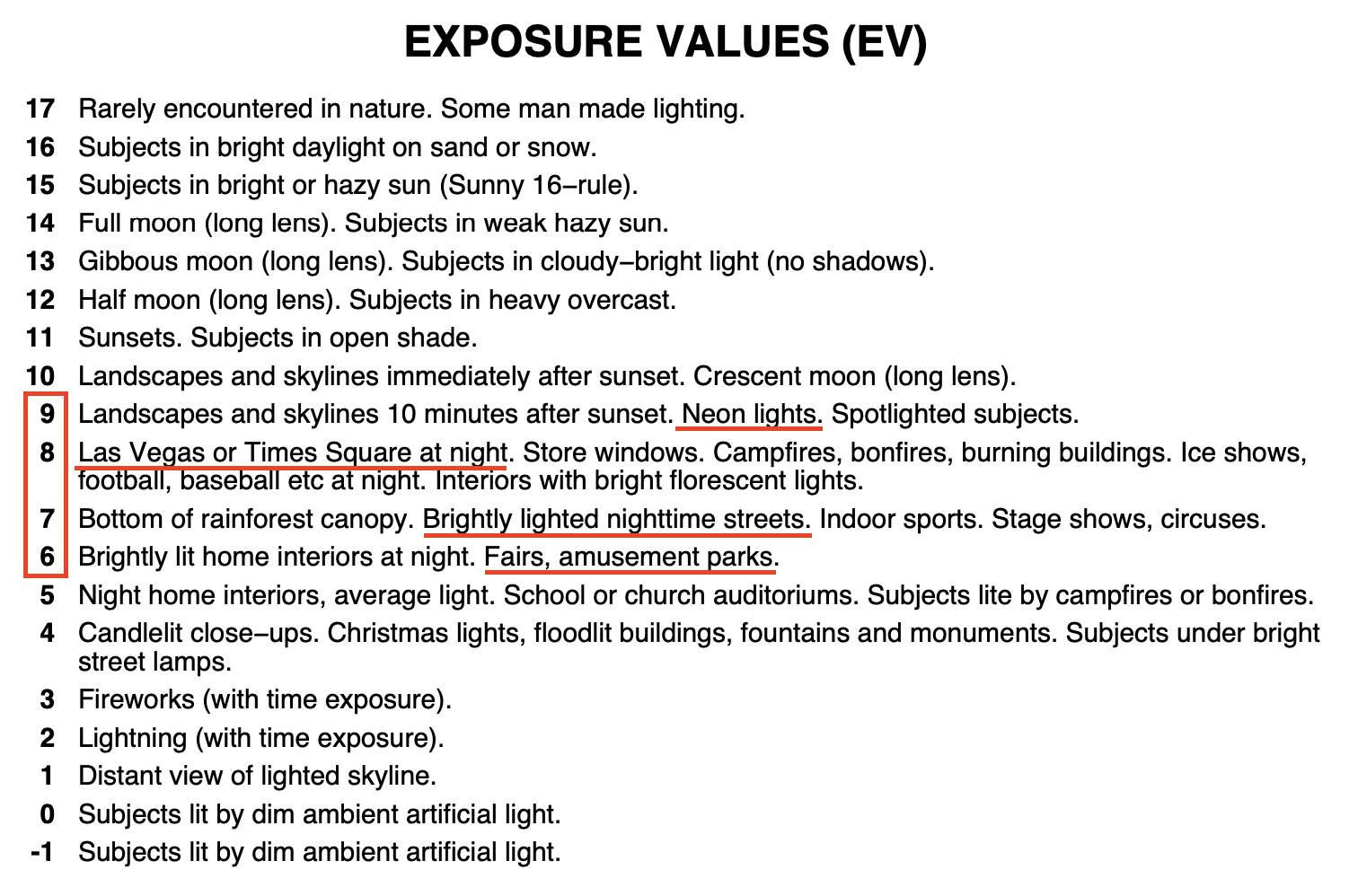

There has been some discussion about what kind of shutter speeds to expect if shooting neon lights at night with ISO 800 film. Of course, the only way to know for sure would be to expose some film under actual shooting conditions.
Several sources have compiled charts of various lighting conditions and assigned an EV (Exposure Value) to each level. One such chart is included with the "Jiffy Calculator" which I copied from <this web site> and reproduced below:
In the chart above, an EV of 9 has been assigned for neon lights. But to be conservative, let's look at some similar night-time scenes which have lower EVs like 6, 7, or 8.

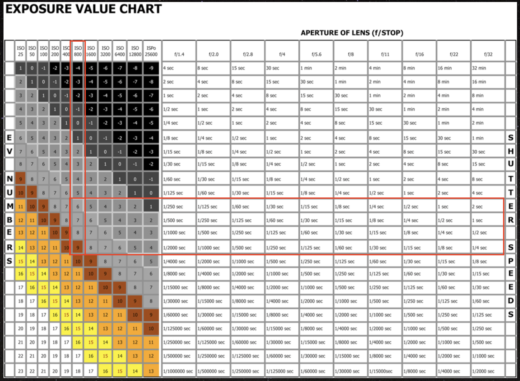

<This website> provides a chart to convert EV numbers into combinations of aperture and shutter speed. Looking under ISO 800, at the row for EV 6, the chart indicates and aperture of f/2.0 would need a shutter speed of 1/125 sec, and at f/2.8 you could shoot at 1/60 sec. So even if the actual EV is 2 or 3 stops less brightness than EV 9, then the OP should be able to get hand-holdable shutter speeds with his 50mm f/2.0 lens. And if his neon scenes are actually EV 8 or 9, then it may be possible to use some mid-range apertures before his shutter speed drops below 1/60 sec. This is all hypothetical, of course, and needs to be proven for actual conditions. I hope the OP will post some results.
Excellent! Thanks for posting.
