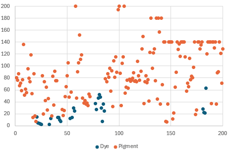

Look e.g. here: https://www.aardenburg-imaging.com/light-fade-test-results/
Here's the first 200 entries plotted against each other, separated in dye (blue) and pigment (orange dots):
Light-fastness (as expected MLux hours of display lifetime) on vertical axis; the spread on the horizontal axis doesn't mean anything. For the light-fastness, I took the average of the range Aardenburg gives, and when he says ">140" etc. I just left out the ">". This explains why some of the pigment points are clumped together on a horizontal line at 140, 180 and 200. The small cluster of "chromogenic" is RA4 paper processed in a Frontier minilab; I assume this is the lower-grade Crystal Archive and not DPII (it cannot be Maxima since that doesn't go through minilabs).
It shows that while there are some really bad pigments, there are no good dyes in terms of light-fastness. The bad pigments turn out to be virtually all 3rd party ink sets at the lower end of the market. It's quite possible that these perform badly because they are pigment inks with dyes added to shift the hue or to increase chroma; these dye components fade faster than the pigment.
The relatively well-performing dyes (on par with the lower end of the non-shabby pigment range) are the ones Fuji use in their Frontier inkjet minilabs. Those are relatively light-fast.
The data moreover show that the paper really makes a lot of difference.
So no hard & fast rules, but there's a clear pattern. Another very clear pattern in the data is that inkjet manufacturers do not invest in dye-based inks. So apparently, despite the supposed lack of hard facts and the higher chroma of dyes, they don't think it's a good idea to put their money in dyes. I think that says something.
