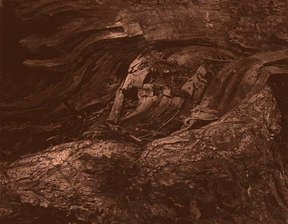

This is Ilford Multigrade IV RC Satin surface toned in the no longer manufactured Agfa Viradon Brown toner:
It looks slightly more red than in real life.

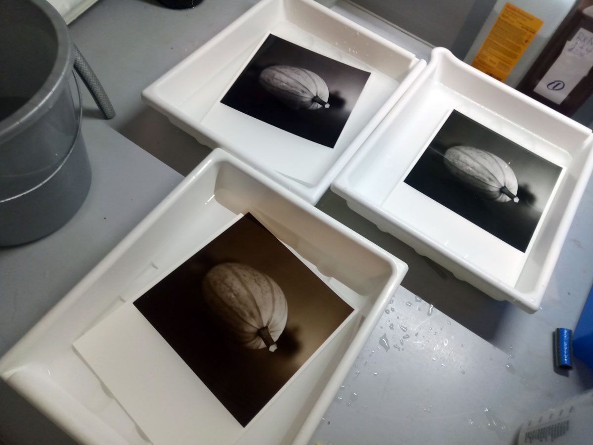

I added an example of the tones that can be achieved with Foma Sepia Toner. The paper is Fomabrom (fix grade). For comparison, the prints in the background are untoned (right) and KRST 1+9 (left).
This thread has some info on the Berg bleach. It is presumably based on copper sulfate (not Blue Curaçao :laugh:) You could just give it a try. In any case, make sure you rinse the paper thoroughly after bleach.

Yes, it was fully bleached. Fomabrom is Foma's neutral tone graded FB paper. My examples were developed in Neutol WA. The image tone of Fomabrom Variant (the variable contrast version) may differ, IDK. I think I also have some examples of Fomatone Classic (variable contrast warm tone FB paper), but would have to check.
