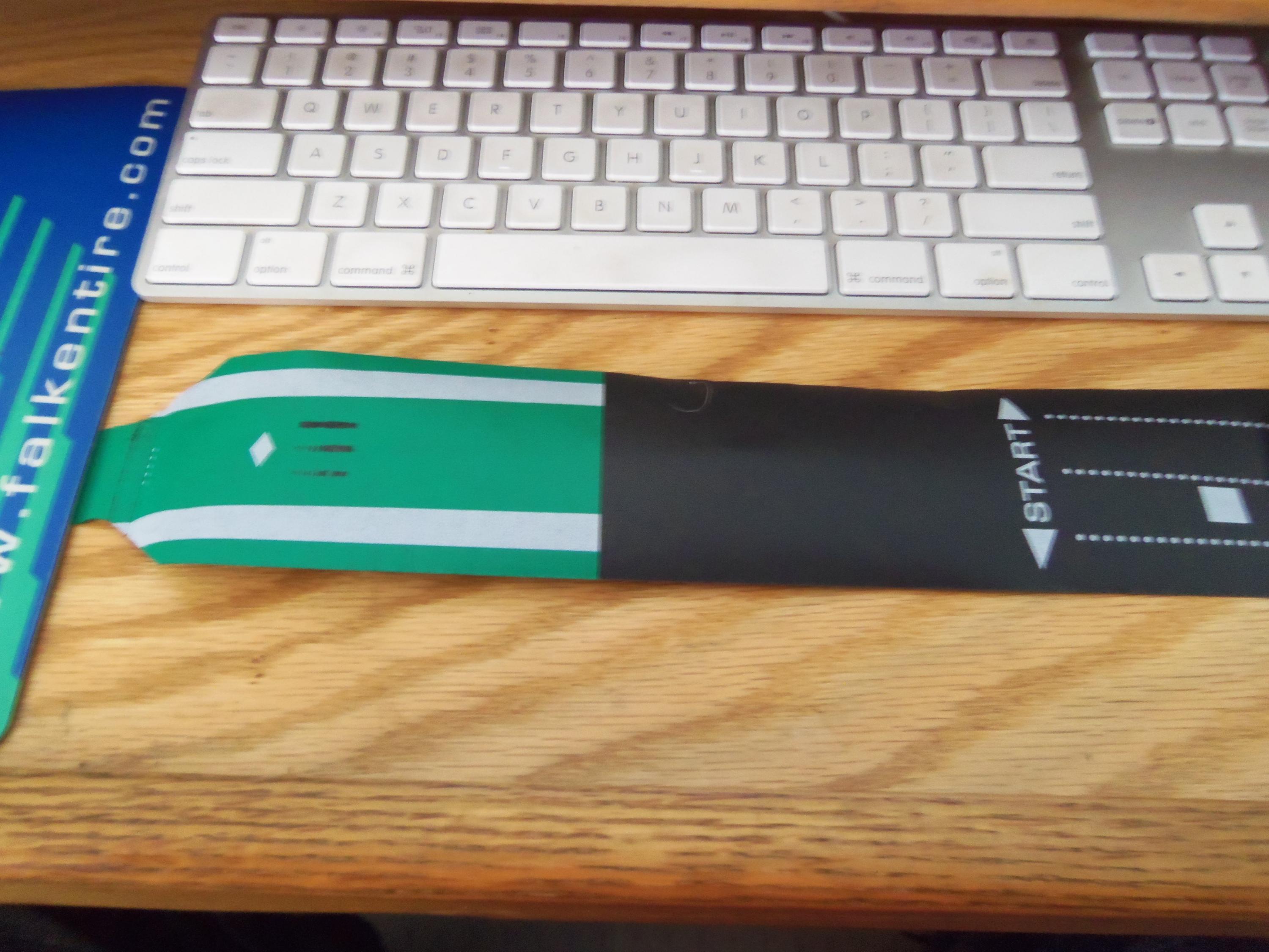

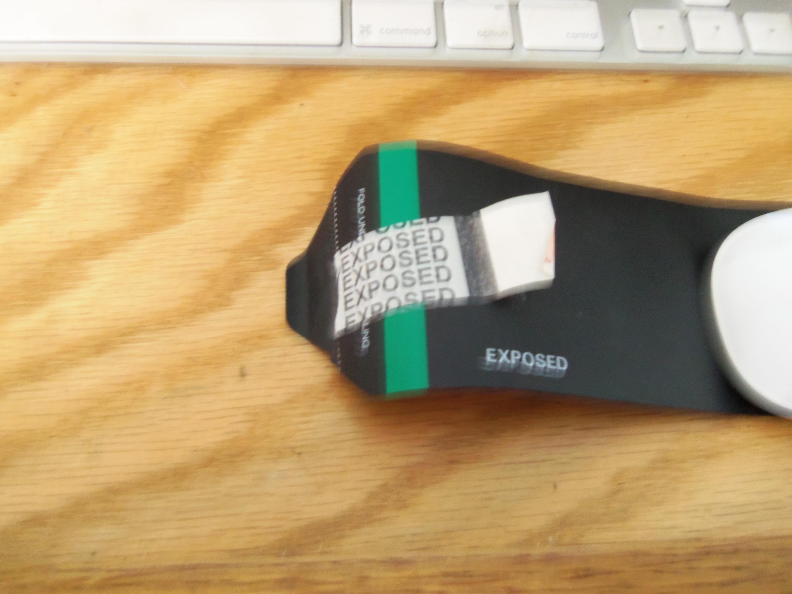

I have a roll of Rollei 120 film. I shot it at 400. The paper starts dark green and then is black until then end where it has a dark green bar. The film is at least five years old. How long should I develop it in stock XTOL?

The beginning of the paper does not have any words.

See below

I took the roll paper ti Samys and they think that is color or black & white lomo film.
What are the development times for stock XTOL or replenished XTOL for R3 and SuperPan 200? I cannot find that.

I cut off a piece and developed it. There was no rebate markings. I developed the roll in stock XTOL for 10 minutes. It turned out a bit thin because I exposed it at 400. It was R3.
