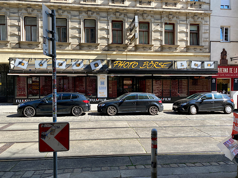

Vienna today
Once I went to my hairdresser, who had her shop around the corner from Camera31.
I came home with shorter hair and a new Nikkor 400/3.5 Ai-S in its original packaging and case 🙃
