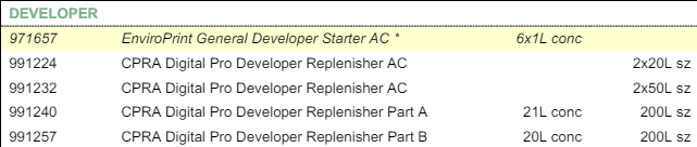

Hey Koraks! Reviving this thread. I want to buy Fuji chemicals and the photo lab in my city can order some for me. They gave me this sheet and asked me what I needed, but I wasn't sure. If you could tell me what you buy for RA4 that would be awesome!! Thank you!! Here's a photo of the sheet:

Ah, that's very kind of them, and for the blix, #22602 would probably be a good choice. However, for the developer, those quantities are kind of big for a home user. You could either ask them if they can give you a printout of the entire Fuji product list they can order, or alternatively contact Fuji and ask them for the product codes of the smallest developer replenisher quantity they can deliver. For the starter, you can use 22660 on that list, but you'll likely only need a bottle or two, not six.

I haven't seen any Fuji professional RA4 presentation that makes less than 20 liters of working solution, and they were rare. So it is very probable that DIGITAL RA PRO Developer-Replenisher 2x20 liters is the smallest kit you can get. Or you convince your photo lab to split the quantity.
AFAIK this is correct; I've never seen CPRA in any smaller quantity than 2x20L. To be clear: this makes 2x20L working strength replenisher. The actual bottles are smaller.
From here; this is the 'pro lab' developer and this is what Fuji recommended to me and others for darkroom printing.

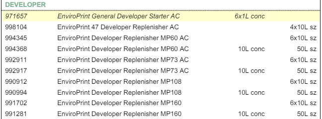

There is also minilab-oriented chemistry, for instance:
Note that these are all fairly big quantities, but a 6x10L pack can be split out and distributed across several users.
There's also chemistry aimed specifically at 'fast processing'; it's on page 2 of the pdf linked to above:
Personally I have used the MP90 developer above for several years for tray and roller transport processing.
The CPRA developer is a triple concentrate (A, B and C parts) much like Kodak Ektacolor. CPRA blix is a two-part concentrate; a bleach and a fix part.
The EnviroPrint developer is a monopart concentrate; it is a single bottle. Very convenient, and despite this, it keeps fine for a few years at least in the original packaging. EnviroPrint blix is also a monopart concentrate.
With these developer replenishers it's important to also get the starter to be able to mix the working strength developer. How much starter is needed depends on how much working strength developer needs to be made, and this in turn depends heavily on whether you'll run a replenished system or not. As seen above, the EnviroPrint General Developer Starter AC is the proper starter for both EnviroPrint and CPRA developers. A box contains 6 bottles of 1l each, but some distributors may sell single bottles.
The situation with blix is a little less confusing because for some reason, a fairly small quantity (e.g. 2x10L) of blix nearly always pops up on product lists. Whether it's CPRA, EnviroPrint etc. doesn't really matter. For blix, a starter is available but I've never used it and I don't think it's required at all in a typical home setup.
