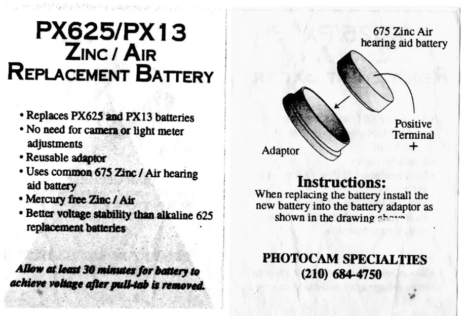

I bought one of these kits from The Olympus Guy many years ago for my OM1. I rarely use the camera now except for copying with the lovely 1.4 50mm lens, but the original replacement battery is still going strong and metering accurately. There are other options on EBay as I believe the Olympus guy is not as active any more.
http://www.ebay.com.au/itm/Battery-...t=US_Camera_Battery_Grips&hash=item3a7fa9265c

Thanks everyone for the comments and suggestions. Very helpful.
Reading upthread about the OM-1 battery, I did some Googling and there seem to be a few sources for this MRB625 battery. Even B&H.
http://www.bhphotovideo.com/c/product/96457-REG/Wein_W9901201_MRB625_Cell_1_35v_Zinc_Air.html
If this really does work with this camera, then an OM-1 does seem to be a good option for me.
Don't bother about the battery. For every OM1 a CLA is mandatory, as this deteriorating foam under the cap which is destroying the prism must be removed. Alongside this every repairsman worth the money will make the conversion. As far as I know the OM1n doesn't have this kind of material though. In this case you may, depending on the condition of the camera, get away with weincells.

Well, I bought an OM1n, with a 50 1/4 lens. Also bought some of the Wein batteries and the meter seems pretty accurate, when compared with an iPhone app meter. I'll probably only be shooting B+W, so it just needs to be accurate enough :wink:.
