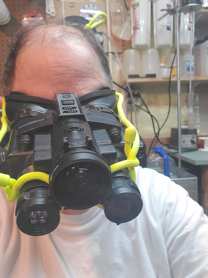

ATN Viper was the best suited to the task, headgear is awkward. Focusing eyepiece and close focuses. Not telephoto (1:1). Don’t make them anymore but great for the job.
Jakks Pacific SpyNet toy IR goggles. I use them for handling film. Extremely narrow view, focuses up close. Only available used, no depth perception, one camera so not truly stereo. I would be screwed without them. I've posted a bunch on these here look around.
Bungee cord or similar to smash to your face so no light leaks.....
