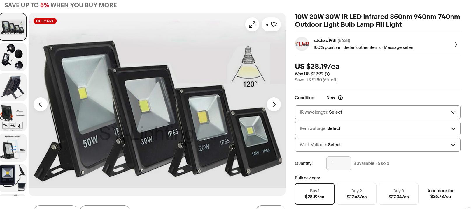

I think it’s worth noting that ambient light goggles won’t (or shouldn’t) work in this application. You really need an IR illuminator for total darkness.

These look interesting as a potential IR light source.

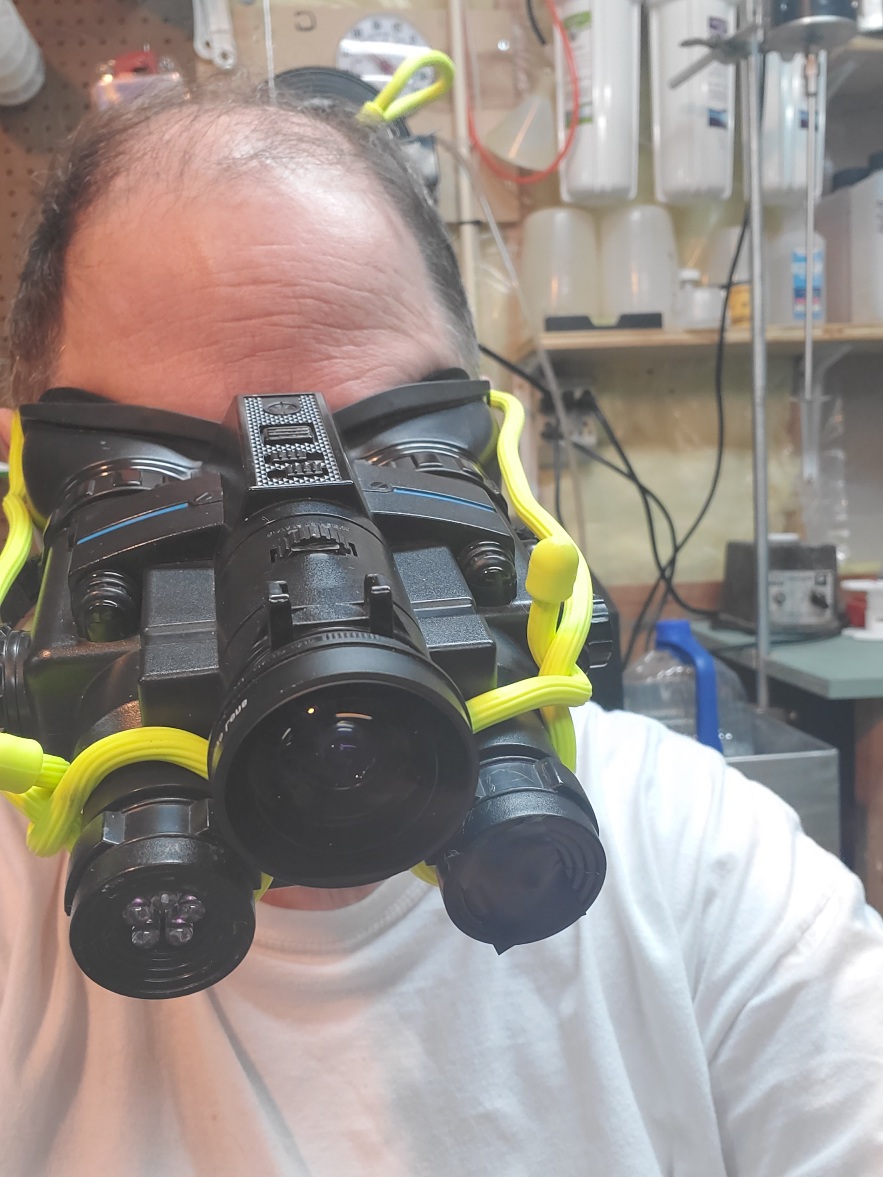

I just received a pair of Jakks Pacific Spynet IR googles I bought on eBay for $30 (free shipping!). Looking forward to trying them out.
