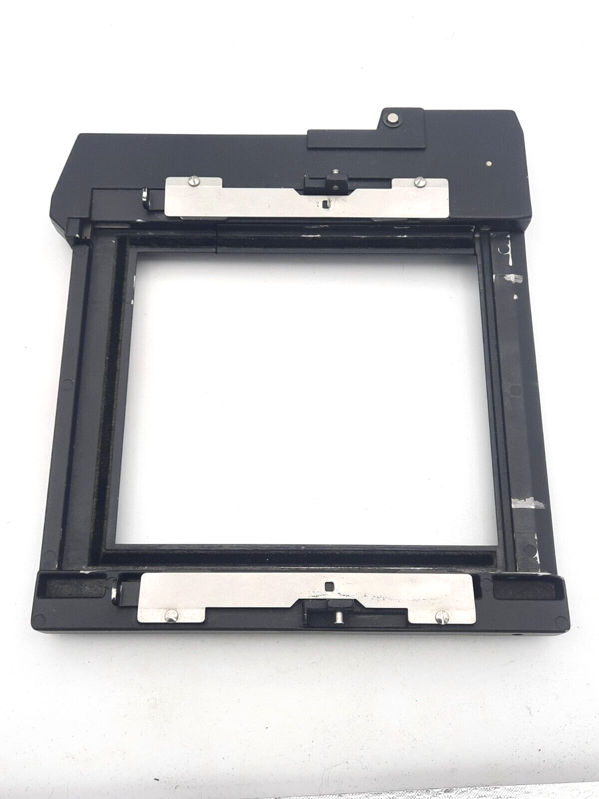

I see a few available on Ebay that include the ground glass, but the cheapest one by far is this one:
My question is: as the whole system is fully modular, i can just buy this and swap out my ground glass (and whatever other bits are missing) from the back i already have, correct?

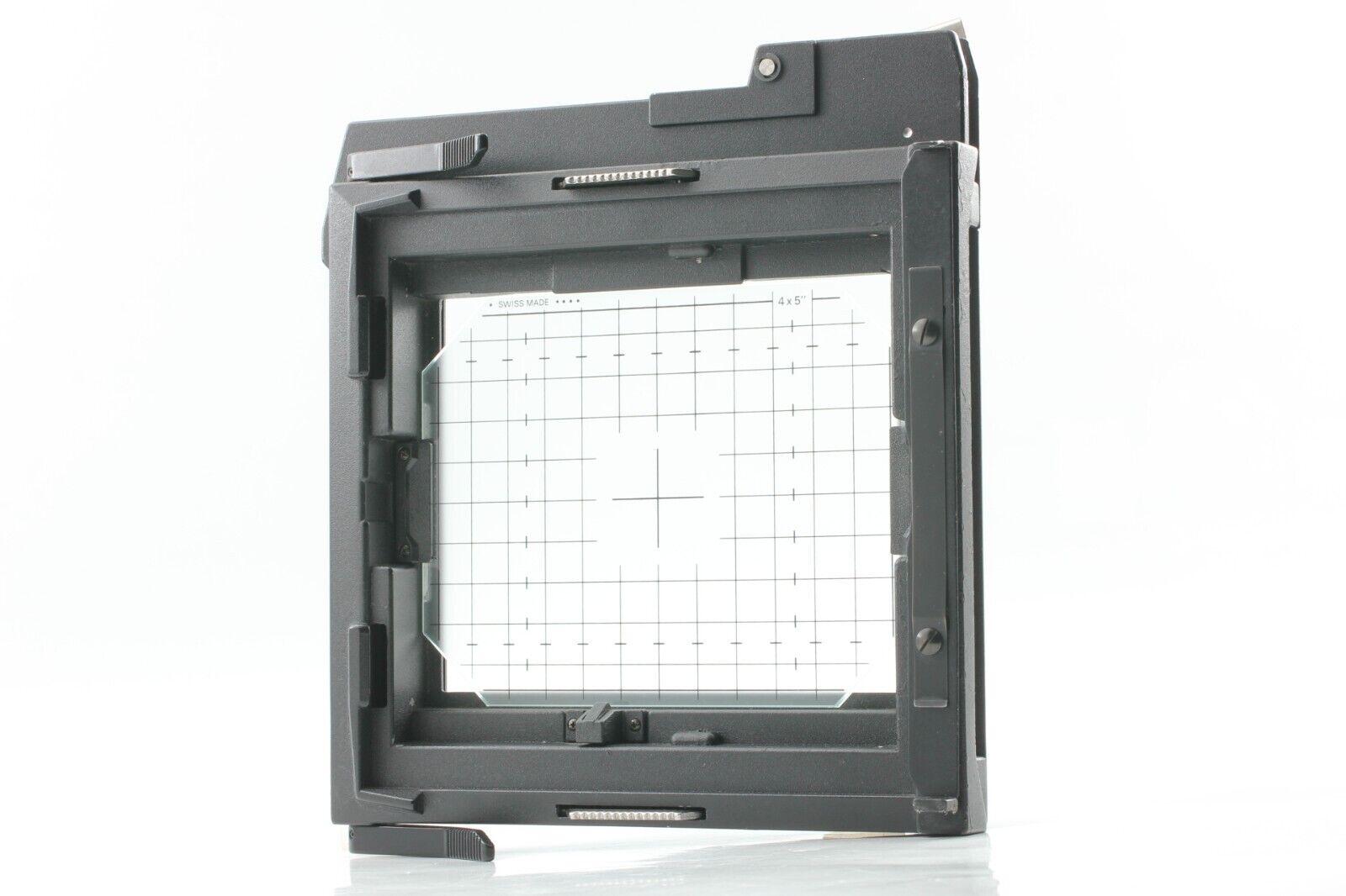

Below is an image to another metering back that has, apart from the ground glass, an extra bit of frame visible, but i presume i can swap this part also from what i already have?

Yes, Sinar backs are modular and you can use your screen frame with the metering back. I have the back as well, if you'd like to buy.
