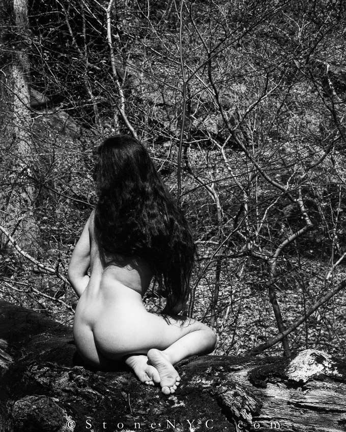

This is what can happen if you trust your light meter in extreme or "difficult" lighting conditions...
That is a model on a branch...
When I turned her (and myself) around with the sun at my back, this was the result (sorry don't have the film, but trust it was MUCH denser...)
I usually use my light meter, and had it strapped to my belt, but was balancing on a the log and figured the in camera meter couldn't have been TOO bad... Not making that mistake... At least in abnormal light conditions...
EDIT I meant on camera meter vs spot.
Your mistake was not using an incident meter when you were photographing a highly reflective subject.
Umm, it was denser because you not only have the Sun to contend with, but there is a fair amount of moonlight in that shot as well. :smile:
