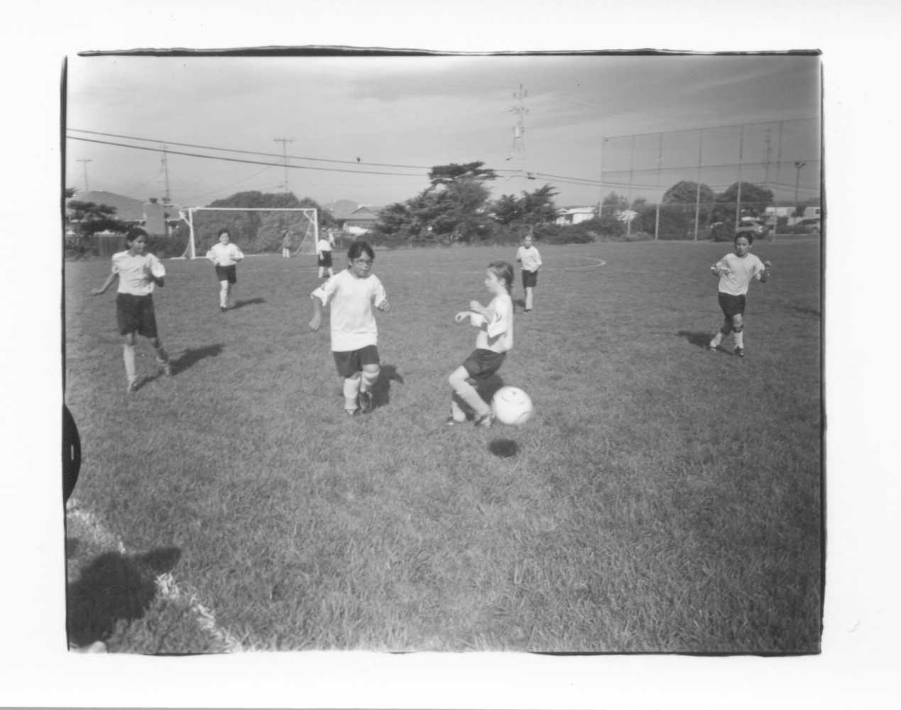

I was not too successful with a Diana Camera...oh, well.

I wouldn't worry about it, Vaughn. You do damn well with an 8x10!
I was going to say that with the 8x10 at least I had them standing still for 30 seconds to a couple minutes -- but then remembered that I think I saw one or two of them standing still on the soccer field for that long during games occasionally!
