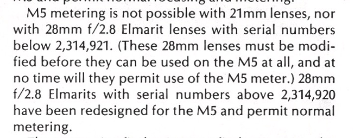

Some non-collapsable lenses cannot be used, either:
You can’t meter in camera using those optics with the M3/2/4 series.
Its good general information for people thinking about which M to buy.
Well the issue with the 21 and the listed 28mm & any collapsible lens that is mounted fully collapsed is that the back of the lens will break off the meter stalk.....

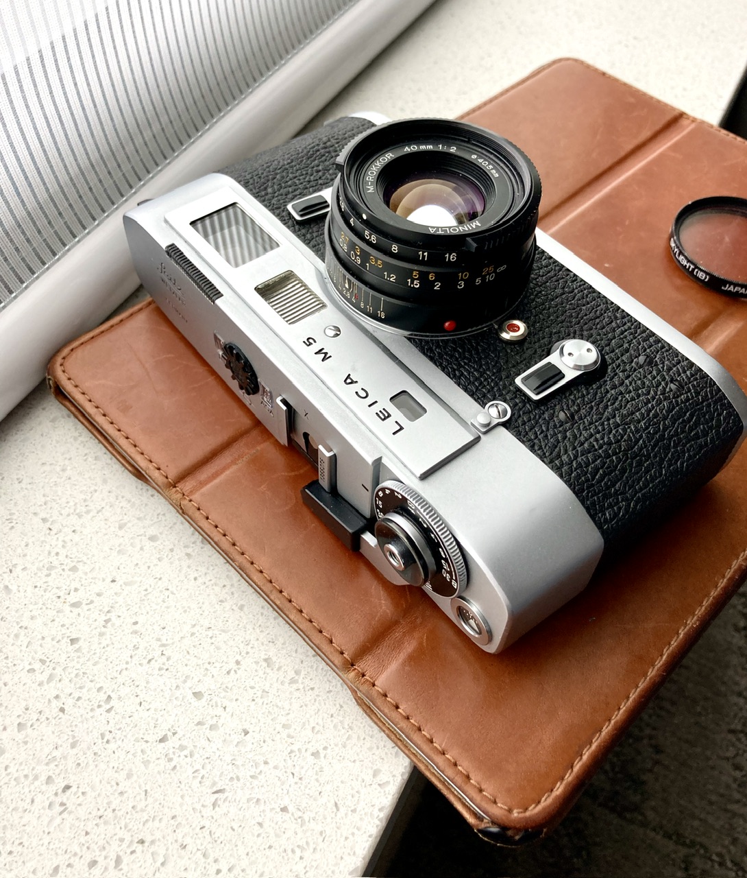

So, since the time I first posted the question, I managed to squirrel away the money to buy both a just-CLAed M2 and an really nice 50 Jahre M5 (now with DAG for overhaul). I'm using the M2 a bunch right now and I love the thing. Because there were only 1750 of that particular M5 made, I told myself I could justify my M5 jones because it's collectable, you know ...
