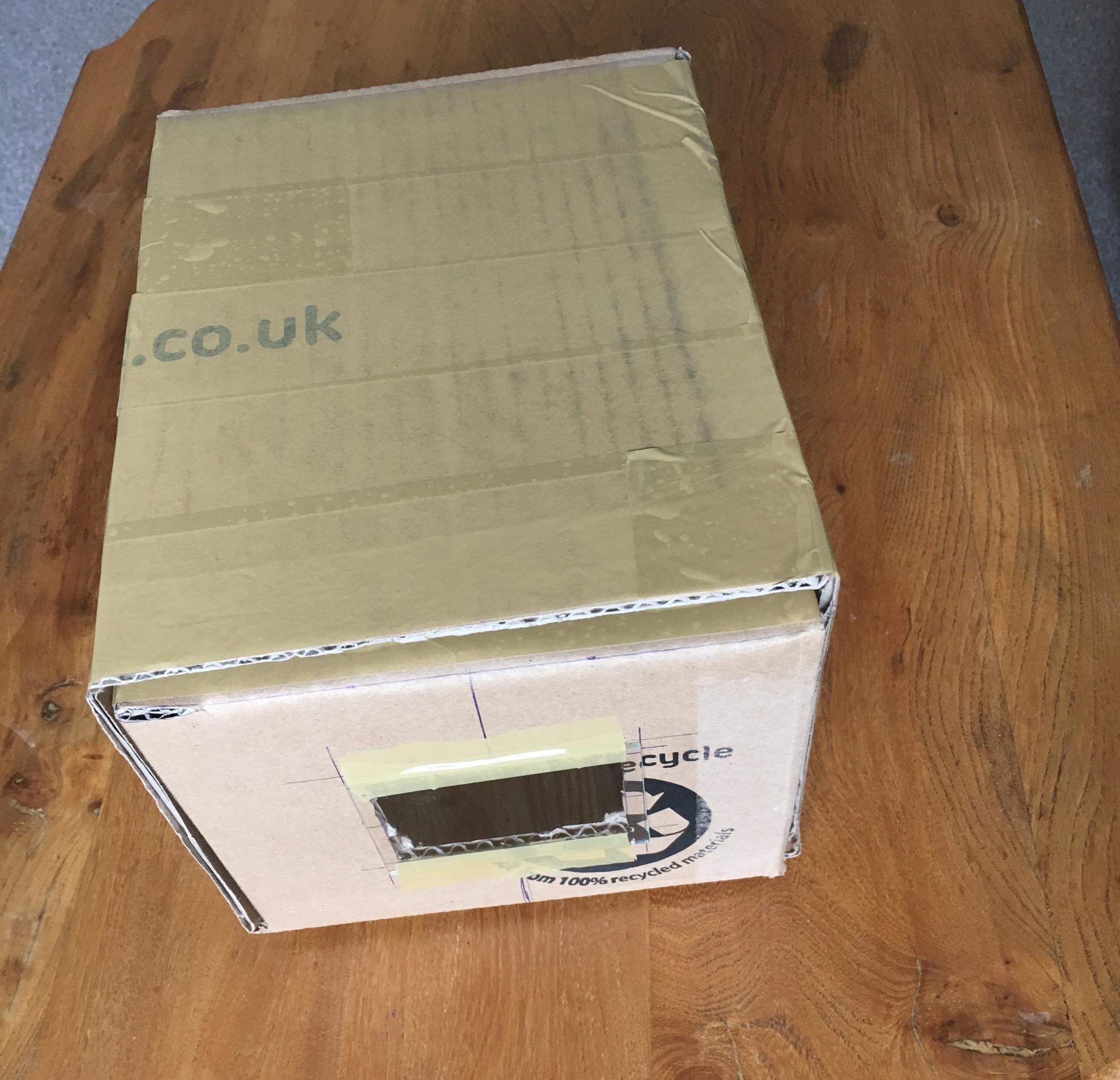

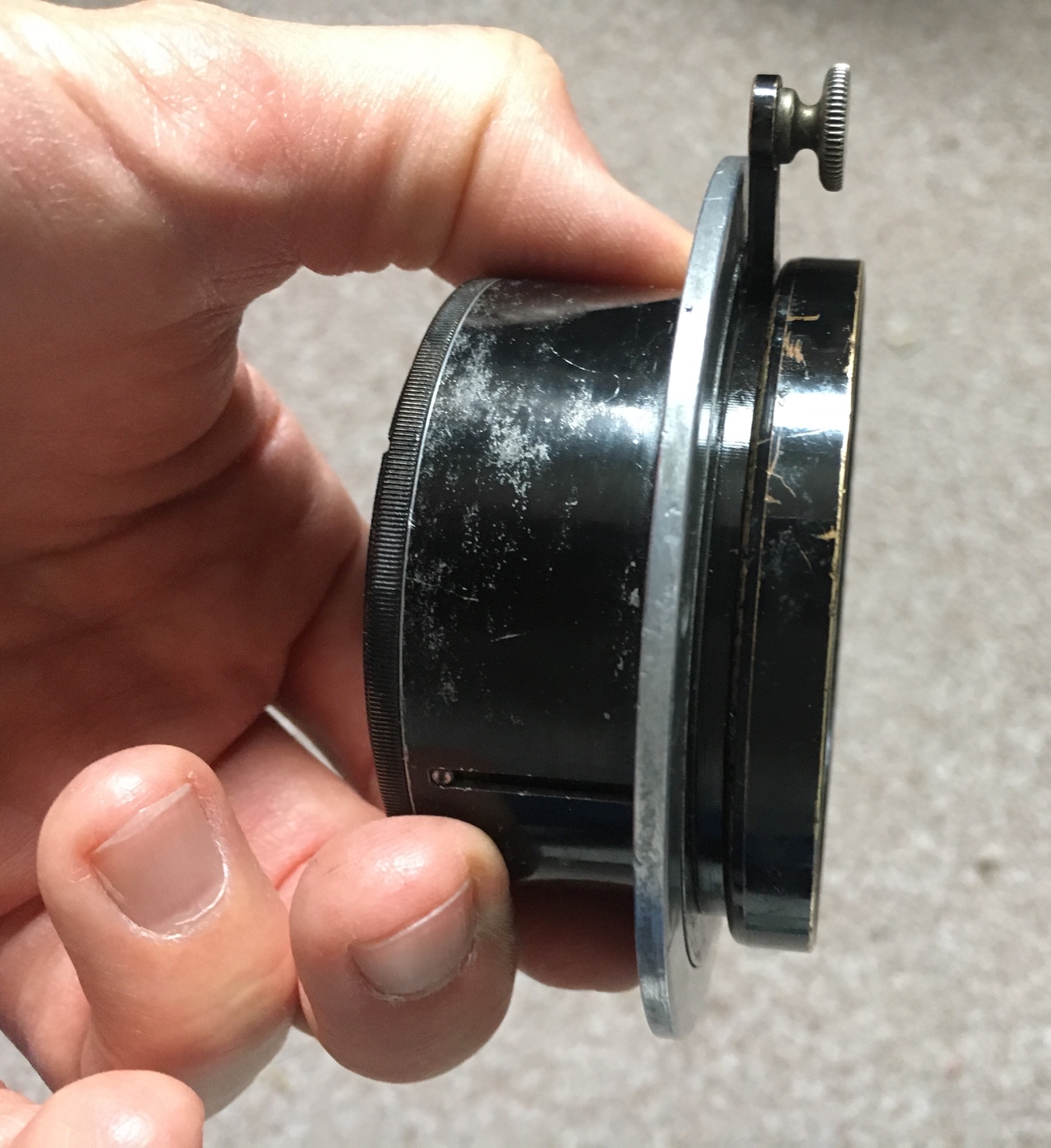

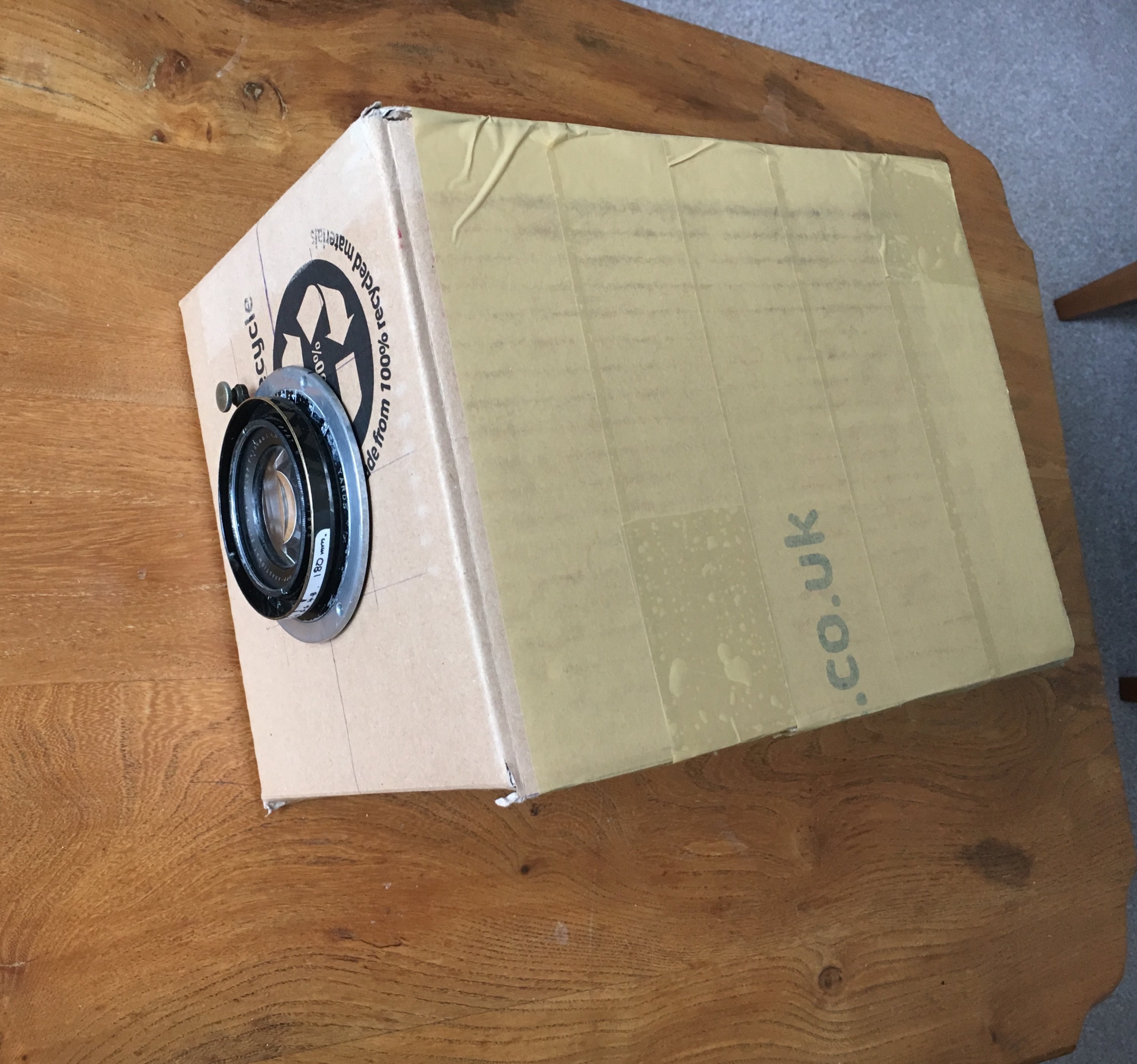

So I made a slide box out of cardboard used a 3 pass black out material to cover it and also my head. I had a small glass and taped it at the back. I focused at infinity and opened up the lens. f4.8 was great till f16 after that it was so dim that I couldn’t see anything.
On the ground glass there was no image at all.
My other problem was that when I slided the box my eyes also started to focus so I couldn’t determine the sharpness. So I moved the camera until I saw the image on its wall. The f numbers didn’t seem to matter in terms of depth of field. The subject was about 50 yards away. That shallow field was about 10mm or a bit less or more. So I assume if the film plane would be there it’d be right. I measured the distance and it was approx. 190mm from where the lens was mounted on the cardboard.
I also used the lens focusing ability and the image apperared 15mm closer to the lens.
I don’t know. It’s a bit like nowhere.
I feel that it’s not beyond my comprehension, but for me it’s getting way too complicated even with a slide box. =D

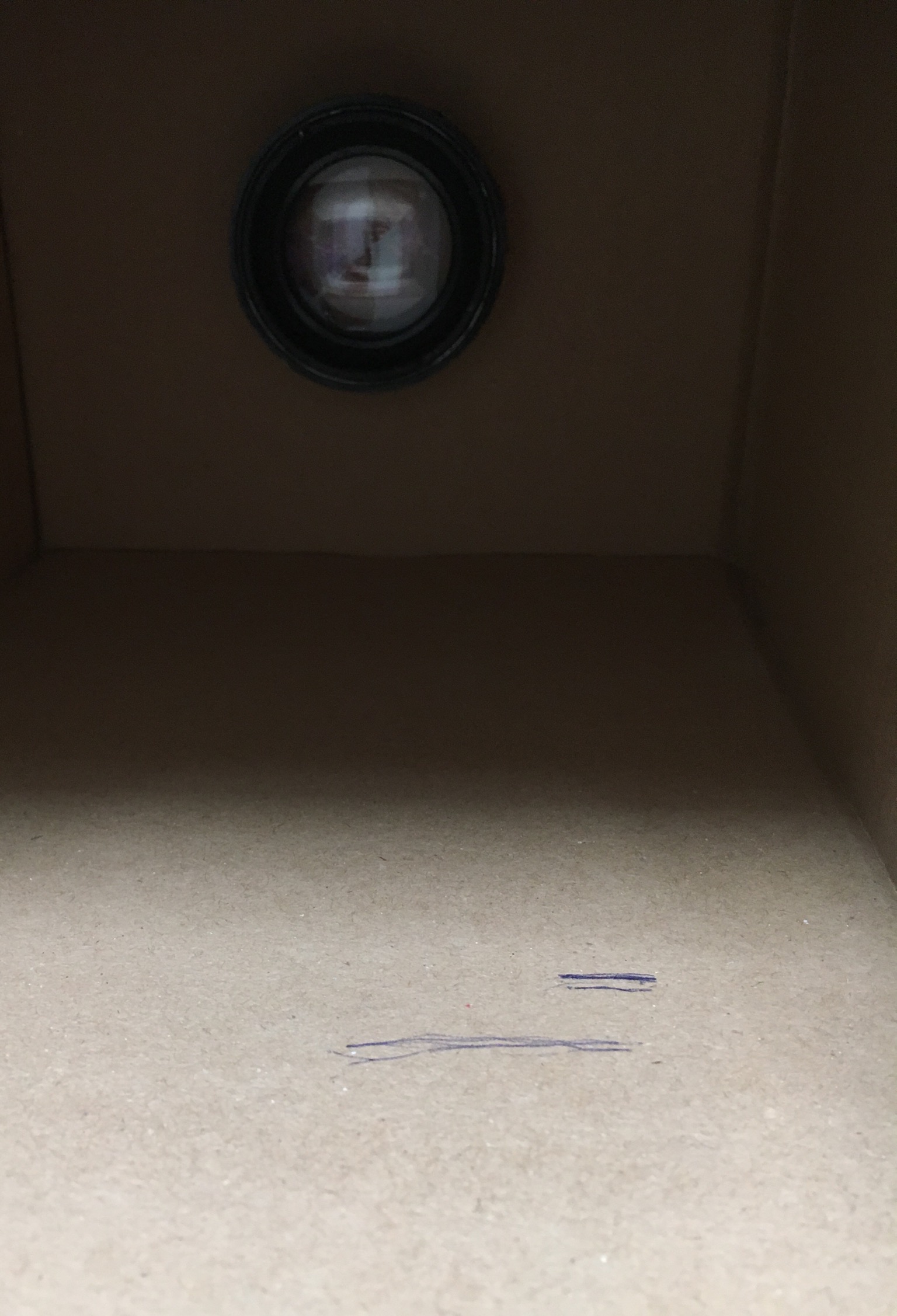

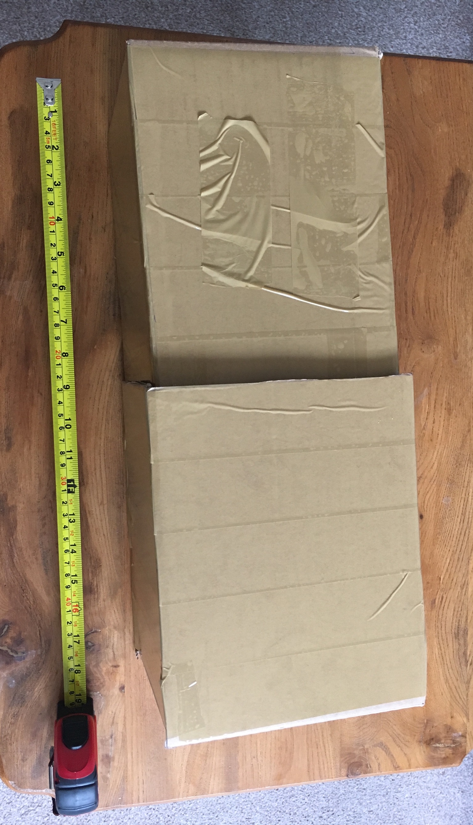

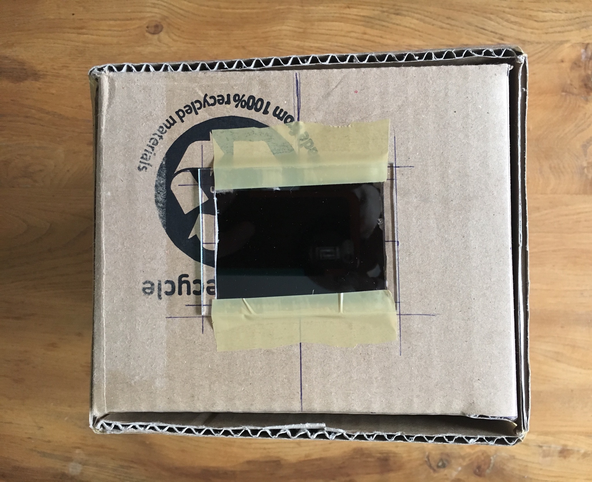

Thanks for the photos. How deep is the box when the inner box is as far in as possible. Why is the GG solid black? And what does photo 140SFCD-... show?
Laci Toth
Laci Toth
Aug 9, 2019
408
Budapest
46cm is the longest distance from the lens till the gg.
The gg is not solid black is just the reflection and on the other photo it’s just facing the table. It’s just a plain glass, I followed NedL’s advice.
140 sfcd shows the lines where the image is sharp, what I could see on the box’s wall. The first line from the us is when the lens is focused to infinity and the second is when it’s focusing approx. 1 yard.

You need a piece of ground glass. Plain glass won't do. Waxed paper has been used as a temporary substitute.

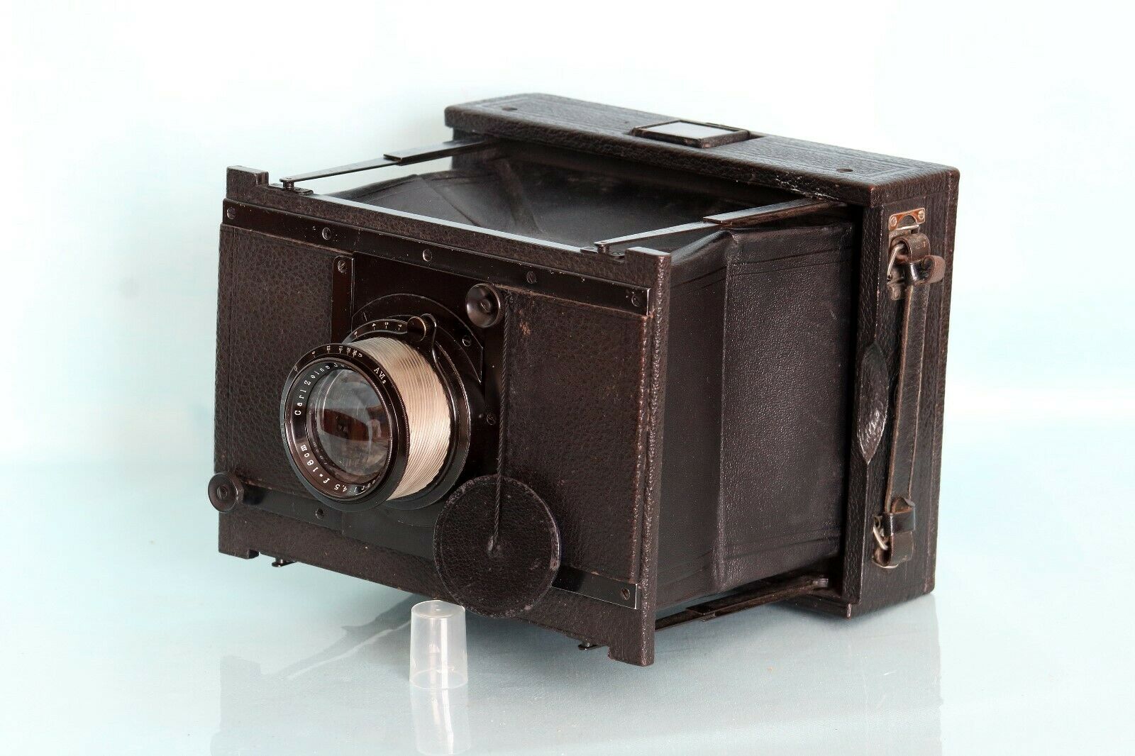

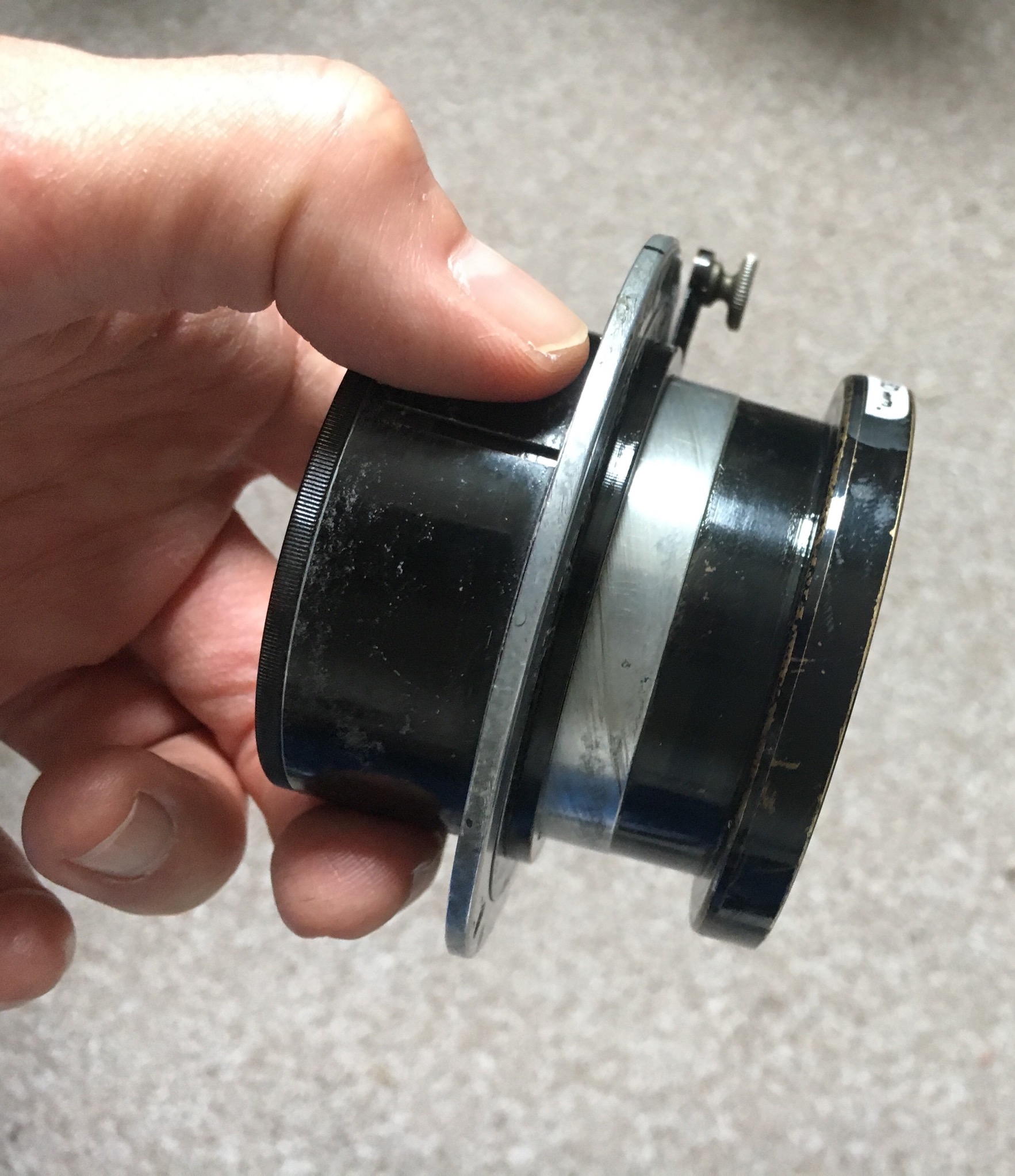

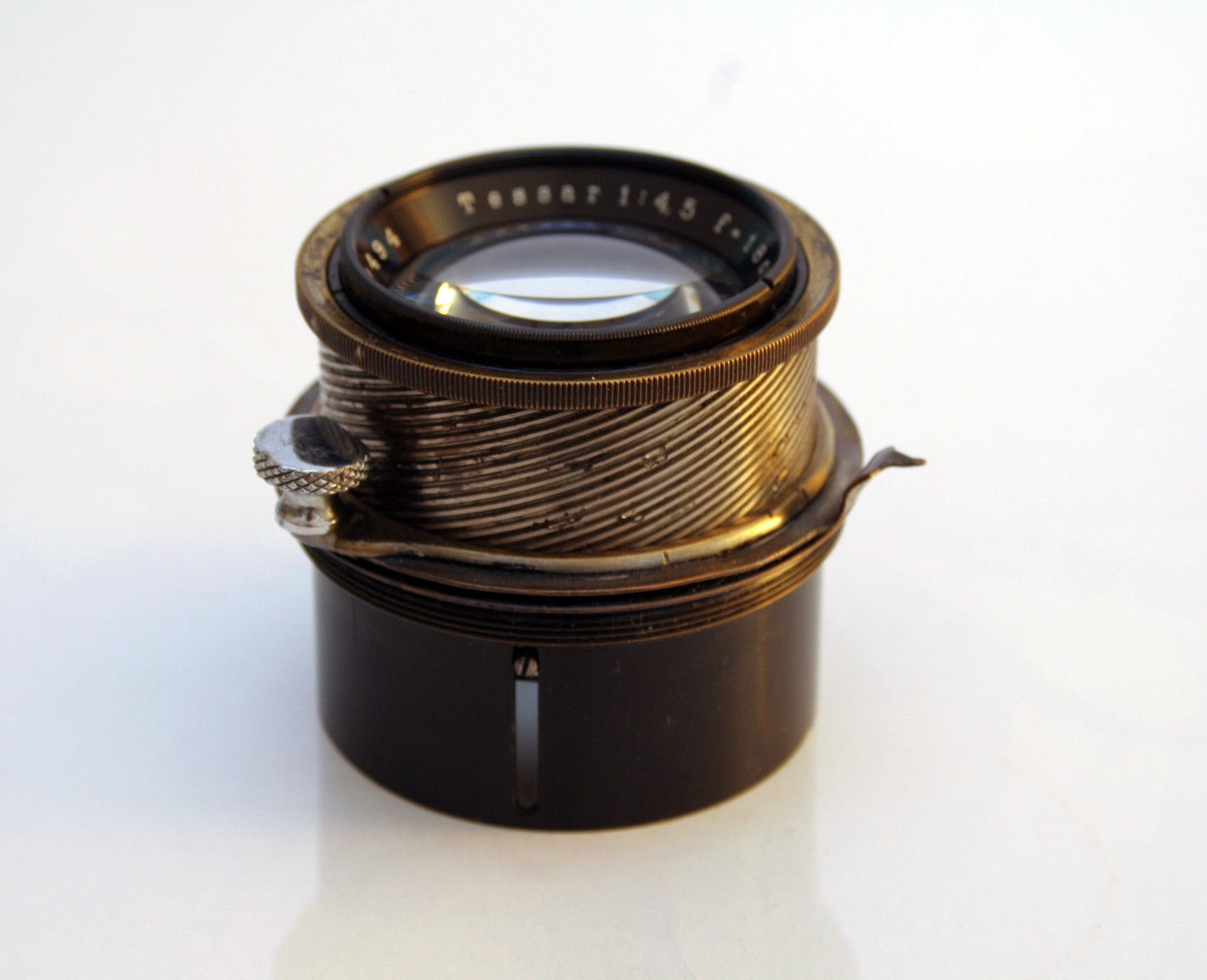

Guess you were asking for LF lenses in a barrel with a helical, perhaps like this one:
Here's a picture of how they used these lenses on a camera:
