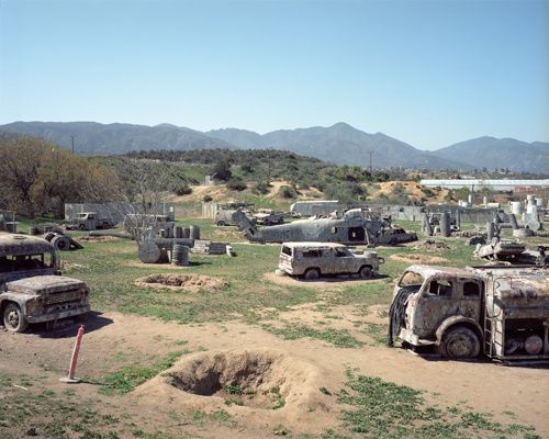

I plan on doing images like this
This was shot on a Mamiya 7II w/ 65mm lens but doesn't look all that great blown up to 20x24 to 30x40

I think you're question should be which camera would be easier to shoot handheld? The Mamiya RFs are fantastic cameras. I have the Mamiya 6 and love it. They offer the sharpest lenses in MF. If your shot above doesn't look great blown up know that no other 6x7 camera system is going to be better (in terms on sharpness). Maybe the Mamiya 7 you used was not aligned properly?

When I last had the chance to shoot at that location my camera settings were ISO 160 f/22 1/125 shutter speed. But that was with the Mamiya 7 so no doubt it's probably easier to handhold. I understand the reason for a tripod but I am not sure it would have helped much in that situation? Plus I wasn't really allowed to shoot there because I was considered a distraction to their business, so I had to shoot guerrilla style (it's why I was using the Mamiya 7) but if I were allowed to use a tripod and take my time I would definitely be using a 4x5 or 8x10 camera.
I was just asking to compare the RZ with the Mamiya 7 because I always seem to see the best portrait work with the RZ series (in terms of depth and sharpness) and didn't think it would be too far of a stretch to see how it would do on landscapes compared to the Mamiya 7 I've used. I do believe the Mamiya 7 I was using might not have been aligned properly because in my opinion the whole image looks just the smallest tad out of focus when blown up. Still useable but doesn't seem that I nailed focus even though I aligned the rangefinder properly when focusing...too bad I sold it shortly after otherwise I'd get it fixed or looked at now.

You can't get there from here. More precisely, printing 20 x 24 from a 6x7 neg (56 mm x 68 mm) requires around 9x enlargement. That's near the limit of what color film can give with impeccable technique. Shooting handheld isn't good enough.
30 x 40 needs around 13x. You really need at least a 4x5 camera and impeccable technique to get prints that large that will bear close scrutiny.
Y'r only other option is to shoot only subjects with no fine detail.

I understand. I wasn't sure or not if I was pushing the limit of the negative trying to print that size... now I know. Next time I get a chance to shoot at that location again I'll see if I can sneak in a monopod or tripod and see how much of an improvement I can get on the next batch of film.
