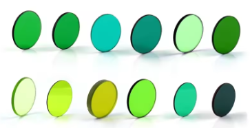

I’m looking to buy color filters (green, yellow, orange, and red) to use for analog black-and-white photography.
When searching for a green filter, I’ve found several options with different “strengths” of green, and I’m not sure which one I should choose.
Does anyone have advice or experience with this?
Which one would be considered the most classic or versatile to start with?
And what kind of differences should I expect in the final image when shooting black and white with these variations?
These are the markings/values I’ve come across:
LB1, LB2, LB3, LB4, LB6, LB7, LB9, LB11, LB16, LB17.

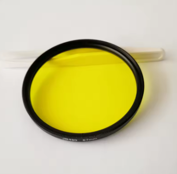

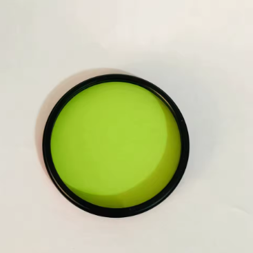

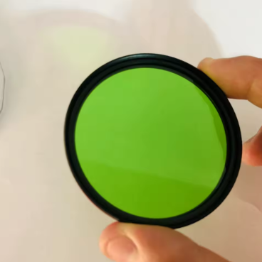

I’ve found three green filters so far: one looks too yellowish, another is a lighter green, and the third seems a bit too dark.
I’m trying to choose glass filters because, as a beginner, I assume they would be more durable. I’d likely follow the same approach when buying red, orange, and yellow filters, which will be the next ones on my list and seem easier to find.

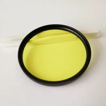

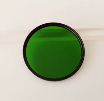

You'll find most people here will refer to filters by their number.
Each number filter has a set of defined characteristics including the density and wavelength of light that is filtered. They are usually manufactured by well known makers of camera filters.
You will also find on ebay and amazon, a lot of cheap random coloured pieces of unknown quality glass mounted into filter holders, that usually stand out by not claiming any particular filter number, and have unknown characteristics.
You can have fun experimenting with them, but keep in mind that in most cases you won't be able to compare your results against others who are using known filters.
