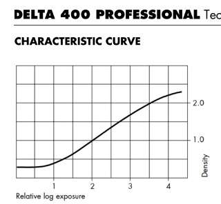

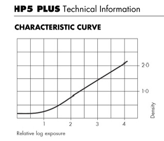

Hello Helge,
How would you talk about those two cuves' differences?
Thanks.
Well, looks like HP5 will retain more straight curve for longer when pushed, because of its initial longer line and slightly lower base fog.
For tungsten plus pushing things might change slightly because of D400s better red sensitivity. But it’s not going to be by much. LED lighting with its lower deep red and no IR is not going to help.
