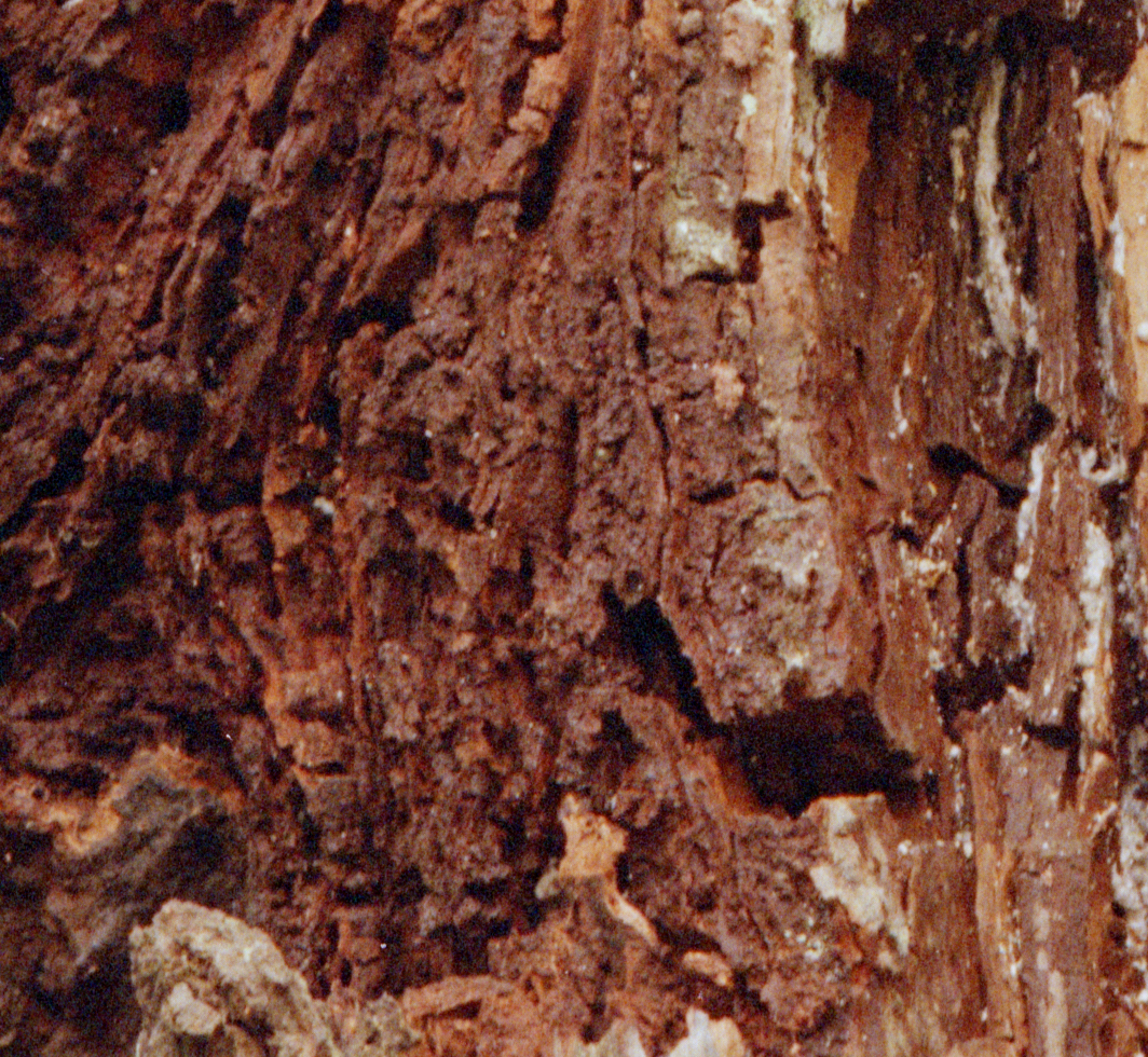

Konica Centuria Super 100 had exceptionally fine grain for me. Though I shot it 1 stop over and pulled process the C-41 rather than develop normally, so larger grains would have less time to develop. I have never seen a colour negative this fine except for Ektar 100. The crop is a 3200 dpi Flextight crop.
