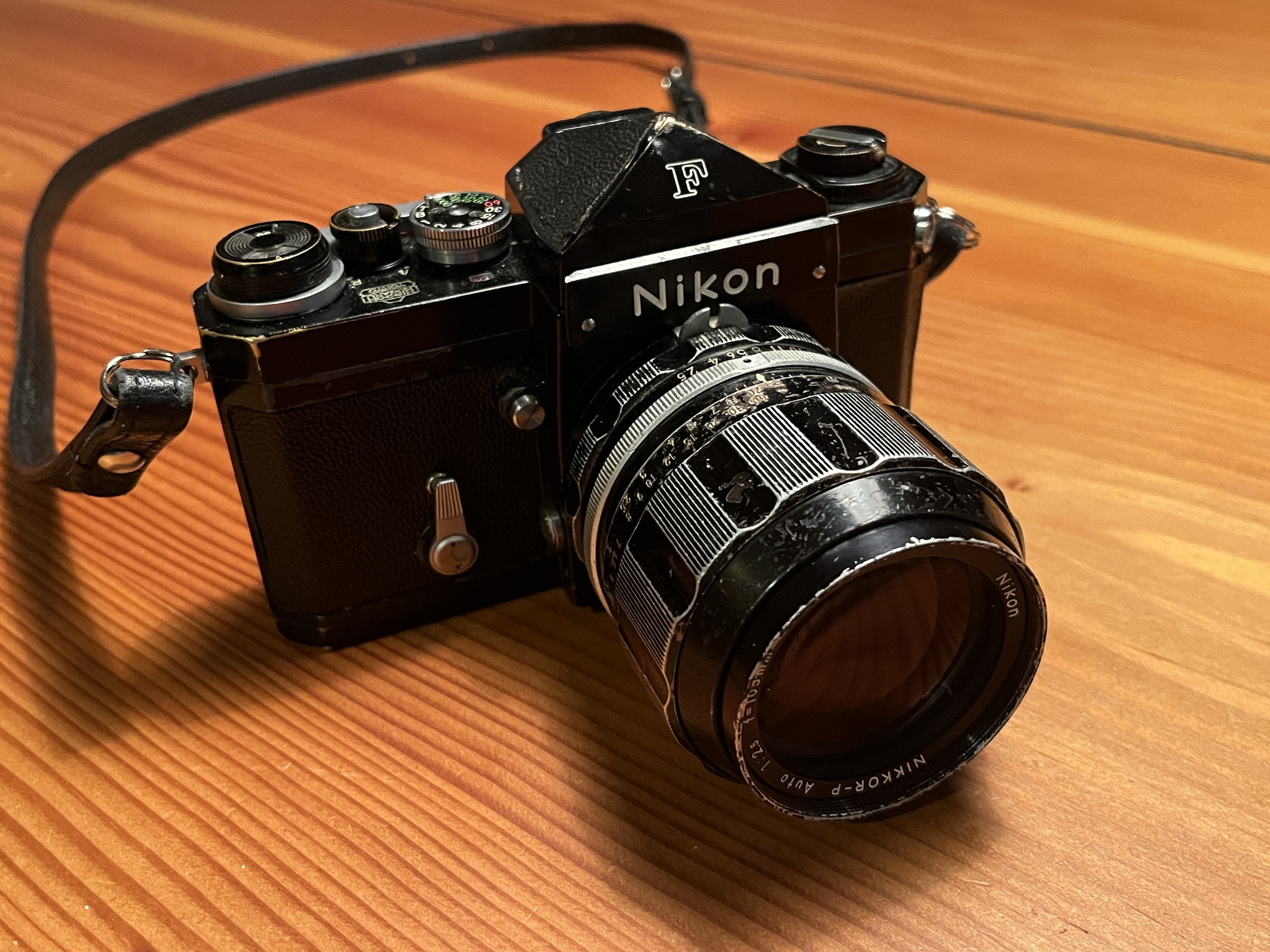

Which black paint to touch up scuffs on lenses

I've used Tamiya paint, sold in hobby shops, with mixed results for jobs like that. It comes in both gloss and flat finish. I tried the flat black on some wear of the finish on a Nikon SLR lens. It looked very good when done but within a few months a lot of it had flaked off the places where it was handled. I put that down to not being able to prep the surface rather than to the paint itself.

Not sure if Humbrol (enamel) paints are available in Europe (or Gibraltar, for that matter!); I've used their satin black paint on a couple of SMC Pentax 67 lenses and really, you would not be able to see the touch-ups! Technique is critically important. An extremely fine, pointed sable-hair brush and thinnest of applications, built up over 6 to 12 hours, is usually more than sufficient. Chips will require filling (fill, then wipe over with your finger to make flush), priming and then painting.
Tamiya Acrylic (TC+number) paints aren't very tough and are water based, but great for modelling. But Tamiya have a newer range of lacquer paints (LP+number) that are far more durable and stick to clean metal even without an undercoat and are easy to brush on. I think you'd need semi-gloss black and remove grease first with isopropyl alcohol.

Doesn't matter if the paint is the same color, it will always look as "touched up". The "touch up" will look worse than the scuffs.
Depends on the lens and the scuff. If it's small, a black Sharpie often works.
+1. I use "permanent" sharpies. Nevertheles you can wash it off with a little bit of alcohol in case that you change your mind. To me it looks much better touched up a little...
