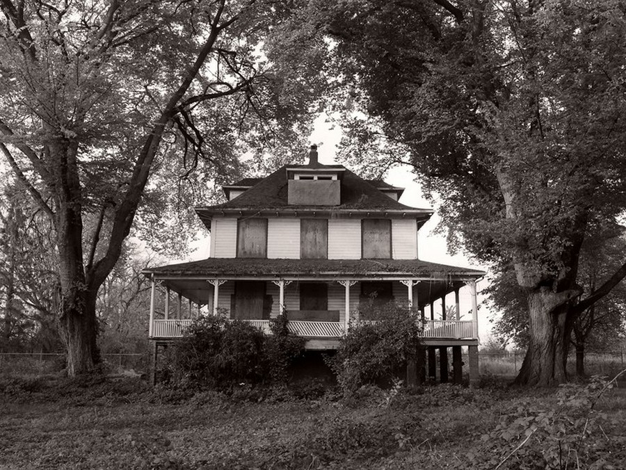

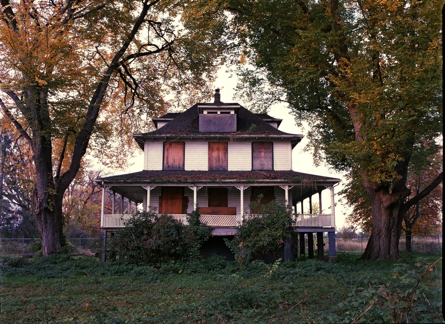

I have nearly matching 35mm bodies for just such a purpose - late model Canon film cameras that can be bought for a song :smile:.
But if I wanted to do this on 120, I would use my Mamiya 645 Pro.
In fact, I have done it with the 645 Pro:
T-Max 400:
Ektachrome 100:
T-Max 400:
Ektachrome 100:
Is that old house still standing?? I shot it with my RB a few years ago. Shot a couple on HP5 and SFX, one after the other. That's what I like about having more than one back.
Yep.
Those shots are from 2020.
It looks just about the same now.

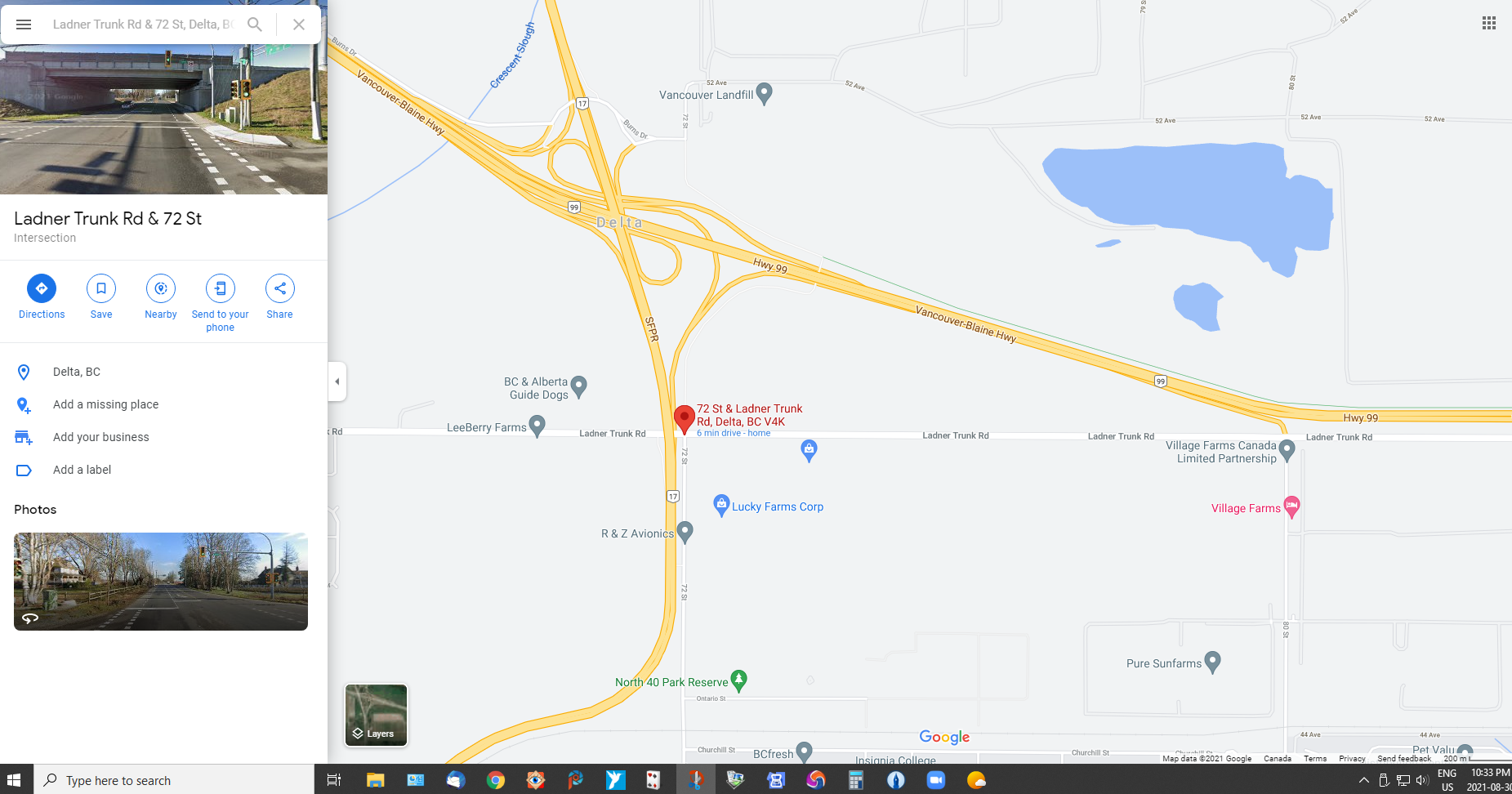

Yep.
Where is this house? Maybe I should grab my camera and get a shot myself.
Did more looking on Ebay at RZ lenses. Most of them are really quite cheap. Some less then $100 bucks like the 100-200 zoom, and some between $100-250. That seems more easily purchased. I dont know why the normal lenses like the 90 and 110 are so way up there in price? They vary between $600-1000.
